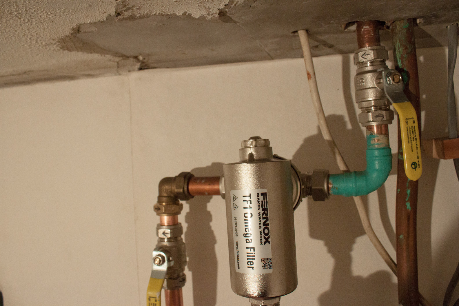

I considered this when I installed mine. Especially because my system is open vent and therefore not pressurised. The valves that come with the filter are a restricted bore as you imply.
However, as I still wanted the option of valves, I bought some good quality full bore lever valves and installed them in appropriate positions. This means there is very little, if any, restriction in the flow.
They have worked great.
(And yes, I know I used "yellow for gas" ones, but they are still appropriate and seemed better quality than the other options....and people are less likely to mess with them)
