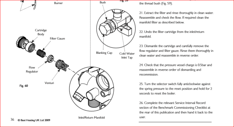

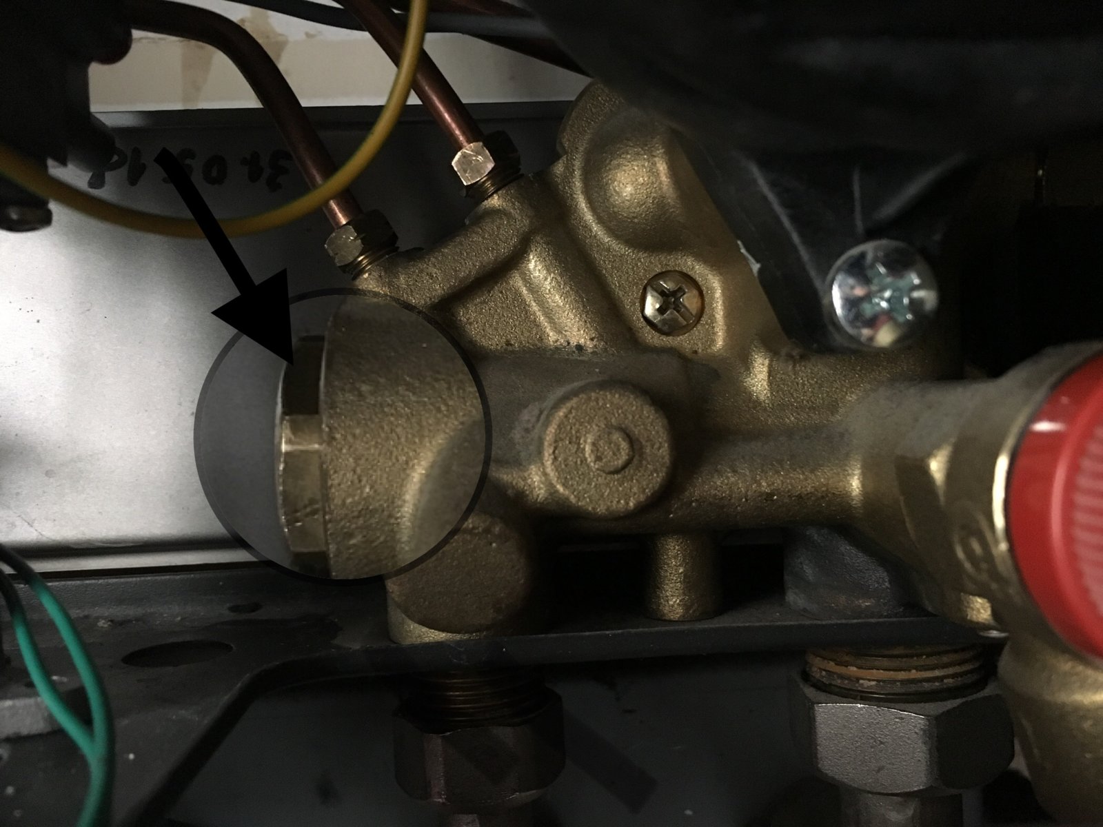

Has the hydraulic venturi been checked :?: its in a housing with a filter and flow regulator. All worth checking :idea:
Thanks for the reply guys, this something I can find myself? I’m no heating engineer but I am a mechanical engineer!
It’s even more so bizarre that the shower issues are somewhat random. Just this morning the shower has been faultless. So early morning late afternoon and no use of the boiler throughout the day seems to remove the issue..
Thanks for that, just what I needed. I’ll report back!
Sent the diagram to my engineer, said it was the part he inspected yesterday with recommendation from Baxi tech support. It was spotless:!: :(:mad:
He said he isn’t convinced that they’d be the cause, he wouldn’t expect them to be causing the pin to cycle in and out.. :sleep:

I still would assume it's the hydraulic venturi, compare it to a new one, it will either be In pieces or the little spring will be out of position.

This being the hydraulic Venturi..? This came out yesterday and was reported to be fine. No debris etc..
It can only be.
Hydraulic venturi
Impulse tubes
Diaphragm
Possibility of a mixer passing
