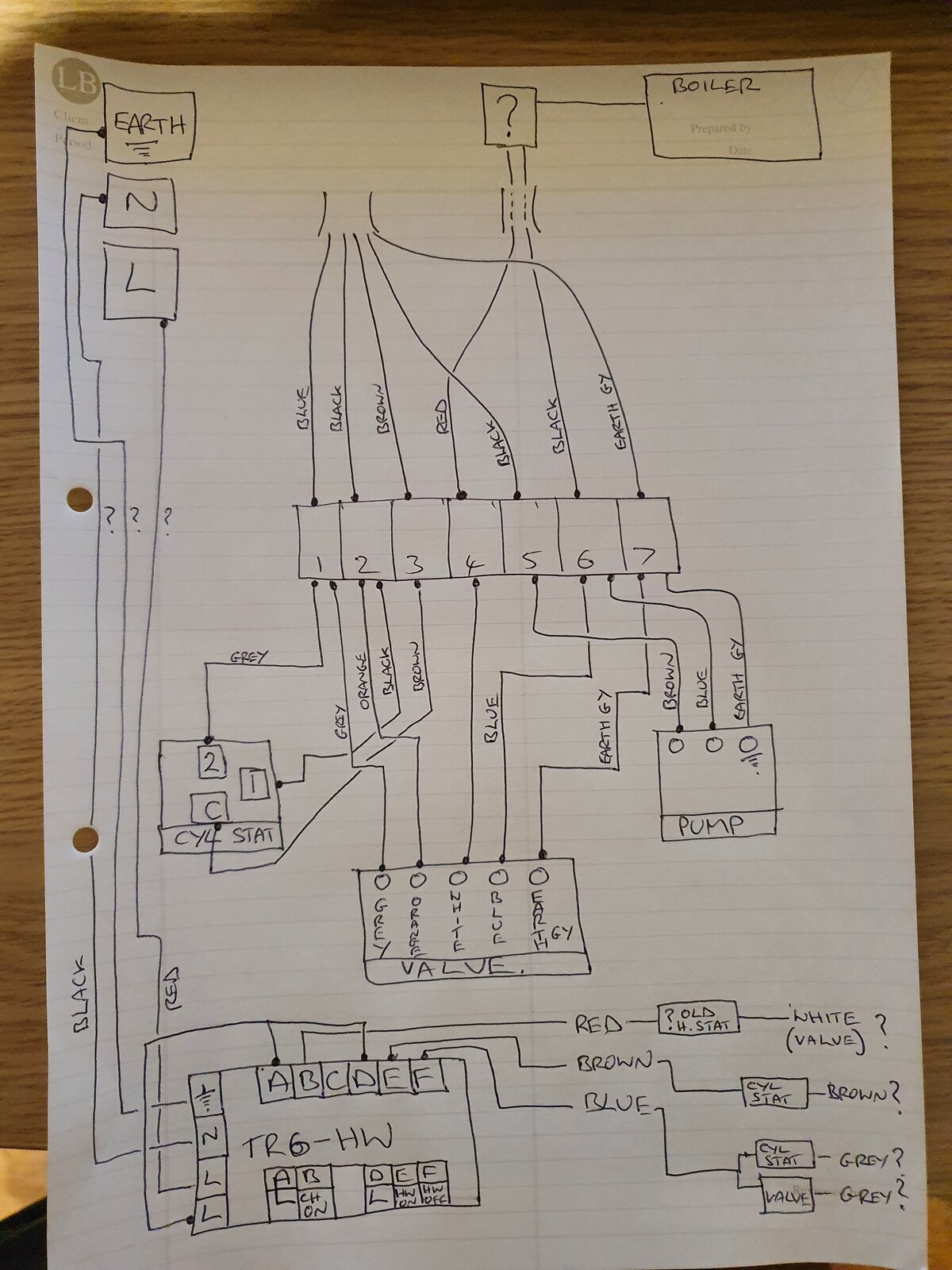

You need to check what your room thermostat is controlling. With the room temp reached as set, the thermostat should switch the boiler off , provided the hot water is also up to temperature. Seems your room thermostat is just controlling the pump, as this was the setup invery old systems - the boiler keeps cycling on/off in accordance with its water thermostat but the water is not circulating because the pump is off.
Thanks for the information.
I have drawn a diagram of wires in my cupboard where the valve, pump, cyl stat is.
I have two cables coming in
One cable with 2 blacks, 1 G/Y, 1 Brown, 1 Blue
One cable with 1 red and 1 black.
I can trace them so far as seen on my diagram.
The red cable coming in appears to come from my old wall stat, so I have joined them together. If I didn't then room stat (TR6) didn't have any control or ability to switch on and off. So cable from terminal B on TR6 goes to the valve.
I think that's as far as we can go : if the cylinder stat and the room stat are both turned down, the boiler should be off. If the boiler keeps recycling with the thermostats off then your system is wired differently. Get a CH electrician.
