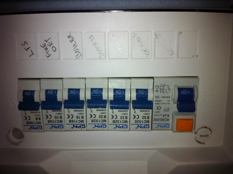

I rent a recently converted barn (about 2-3 years ago), and the master trip switch keeps going here, seemingly for 'no reason'. Downstairs i have quite a lot of (music) studio equipment, but i don't think it's to do with this.
Sometimes it happens during the night when everything is powered off (and the switch on the surge protectors are off too, so nothing is on standby), so to me this rules out my studio equipment.
Sometimes it does happen when i'm plugging something in - but usually it happens when things are 'constant' - nothing being turned on or off, i'm just sitting there.
It does it when the boiler is not kicking in.
I'm pretty sure it's to do with damp, as it's usually a little bit wet outside when it happens. The place is a converted barn, but the conversion is only a couple of years old, so all the wiring etc is pretty new. There are outdoor
I've uploaded a picture of the trip switch unit, it's the main one of the left that goes, under the yellow button.

oh dear - for some reason the picture is upside down. it's the right way round on my computer, sorry about that.

Done 2/3 years ago and not compliant with either 16th or 17th Ed. Regs?
I'm sorry i have no idea. I'll have to look that up...
Do you guys think it could be dangerous?
You know the environment better than anyone here.
What's your assessment of the danger of losing all the lights and the fire detectors because of an unrelated fault?
There are motion sensitive security lamps at the front and back of the property. They can either be set to be on permanently or come on when something comes close by. I don't think i can turn them off completely
Even switching them off might not cure the problem. Only completely disconnecting the faulty circuit will remove the fault. Because of the way your consumer unit is configured it could be anywhere.
It seems as if the only way to find the fault will be an electrician with test equipment.
Probably not dangerous (although without being there to inspect the entire installation, nobody can say for sure), but it isn't compliant in that you have a single point of failure for the entire installation. As you've found out, it's quite an inconvenience if nothing else. The barn would have been far better on a non-RCD feed with the RCD located in the barn itself.

To remove any confusion, I was/am referring to BS7671 314.1
Oh dear, you still seeing imaginary words, I've just looked at 314.1 and I couldn't see the words 'single point of failure'. :)
I don't think you really know what the term means and how costly it is to eliminate 'single points of failure'. A little knowledge ..............., I'll leave you to fill in the missing words.
"314.1 Every installation shall be divided into circuits, as necessary, to (i) avoid hazards and minimize inconvenience in the event of a fault (iii) take account of danger that may arise from the failure of a single circuit such as a lighting circuit"
That in mind, if you're happy to sign your name to an certificate claiming compliance with BS7671 on an installation with a single 30mA RCD incomer, then you either have a very warped comprehension of the regs, very low standards of workmanship, or both. The fact that the OP is on this forum asking the questions that he is should be proof enough of the inconvenience such an installation can cause.
Is all the electronic equipment actually unplugged at night or just switched off or in standby. The mains filters could still be in circuit. This, along with any minor leakage on the outside lighting or off peak heating perhaps, could be causing the trip.
