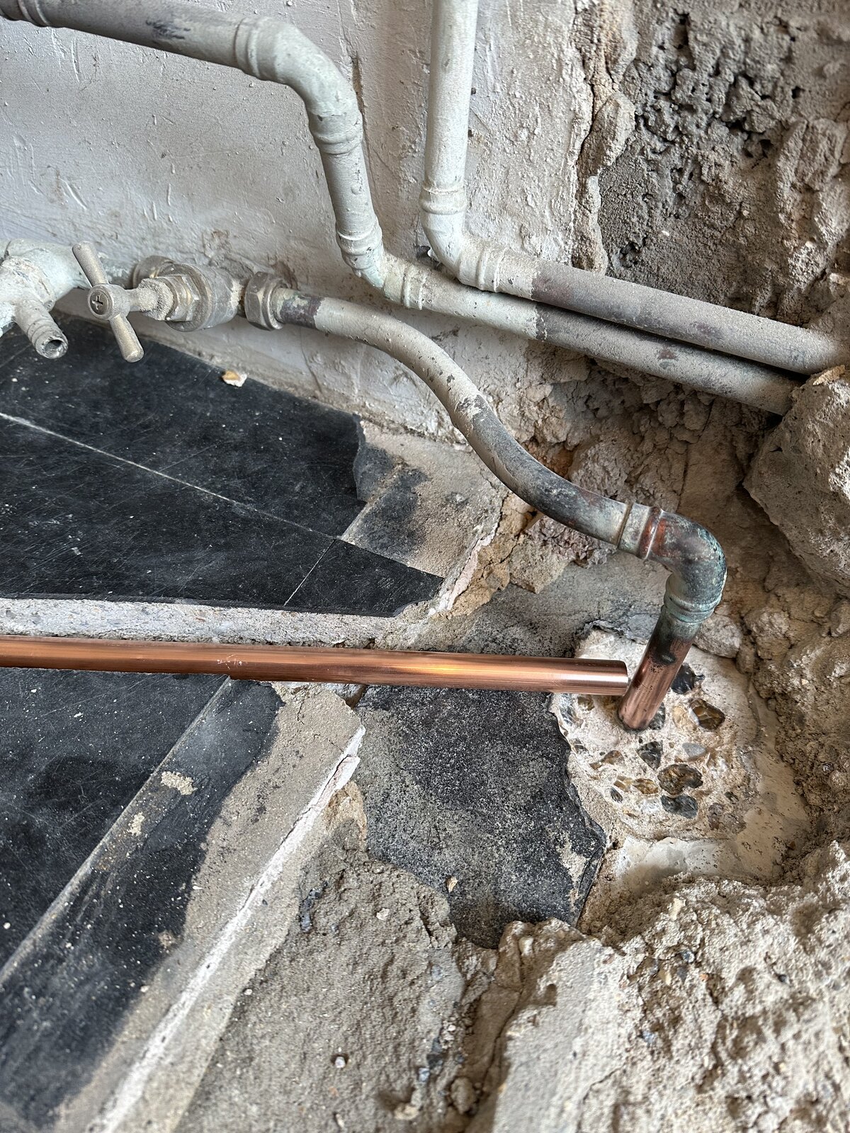

Hi,
I need to move my main incoming water feed. The wall that the pipes presently go to is coming down. I’m intending to move it a 1m to an adjacent wall.
The pipe comes out of a very tough concrete floor and I intend to solder a right angle ( see photo). Although close to the surface I’m intending to cover with a metal plate.
I can turn of the mains out side and can suck water out of the pipe with a syringe to allow soldering.
I guess what I’m asking before I do this is yes/no or any other advice. Any help would be much appreciated before I cut the pipe as there’s no going back

1. Make sure the outside mains tap (stop cock) really stops all water, otherwise you won't be able to solder.
2. If you have one, a wet and dry vacuum cleaner is a good way of getting water out of pipes.
3. I guess that black felt like stuff under the floor is the damp proof course, Take care not to damage it and repair it if you do.
4. Copper and concrete don't go well together, so you'd be well advised to wrap the new pipe in two layers of duct tape before concreting it in. The best stuff to use is Denso tape, but the stuff that makes it waterproof can bleed through.
5. Its best if pipe can be withdrawn in the event of problems. Could you construct a plywood casing to go under and to the sides of the pipe, with a removable top?
6. If you do use metal to cover the pipe, make sure it doesn't touch the copper, unless the metal IS copper, or you can get galvanic corrosion.
Thanks that’s great. Yes, the pipe is only 20mm below the floor level, so I will fix a metal plate along the length flush to the floor ( making sure it doesn’t touch the pipe.
