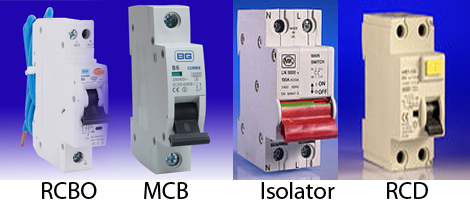

More information needed but, I have to say, if an electrician on site can’t figure it out then a couple of electricians on their iPhones over the Internet will have even less chance.
What is the device that trips? You say main breaker, is this an RCD? What is written on it? Or post a photo.

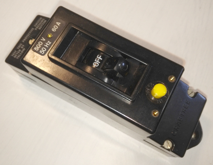

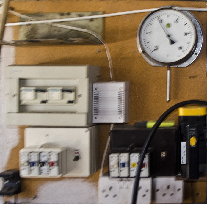

fuse-box-1.jpg Typical 80's fuse box, some times the fuses were swapped for MCB's Wilex-board-with-RCD.jpg picture from my old house showing same type of fuse box with MCB's fitted, and above the left hand fuse box a second box with RCD's although not in my case, these often replaced the older ELCB-v ELCB-v.jpg and when we first started using the RCD we used 100 mA versions which did not trip very often however we then moved to 30 mA and these were a problem when they supplied too many circuits.
This
may help identify what is tripping.
In theory we should test an installation before fitting a RCD and ensure the back ground leakage does not exceed 9 mA when using a 30 mA trip, in practice this was rarely done, and some homes the 30 mA trip could supply whole house without tripping.
However my old house the RCD would have a bout of tripping, they were fitted in around 1992 second hand, when my son became a radio ham at 14 to protect him, and could go 2 years or more without tripping, then trip 3 times a week, and then another 3 years no trip. All testing showed no fault.
I assumed some spikes on the supply, likely a neighbour using a welding set, but never proved, but the problem was really having too many circuits on the one RCD, and to change would mean changing the whole fuse board for a consumer unit, and with this house that is what I did, and have all RCBO's which is a RCD and MCB combined, so any fault only affects one circuit. I also have a SPD (surge protection device) fitted which would likely remove any spikes caused by welding.
Also RCD's have improved over the years, and less likely to trip without good cause.

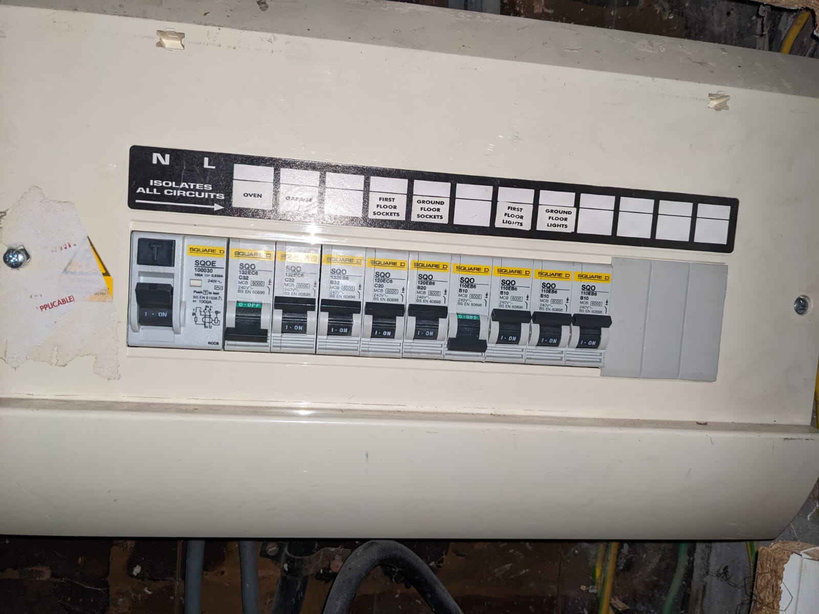

Thanks for all the feedback and here's a pic of the consumer unit.
It's normally the main switch on the left that trips so we lose power to the entire house.
I went through all of the switches checking which circuit did what last night and turned off the ones that are not needed (one powers an old oven and socket we don't use, the other appears to do nothing).
If I turn off power to the upstairs we no longer get trips, even if we use the washing machine & dryer in the garage.

Excessive leakage current due to having the entire lot on a single RCD.
Unlikely there is any fault to be found it it works for weeks/months with no trip.
The solution - a new consumer unit with RCBOs.
If you look at your arrangement, you have a single point of failure and that is the main switch. It can trip if earth leakage is anything more than 20mA. Earth leakage comes from general dampness in sockets, lights etc (especially if outdoors or in humid areas). Also from connected items that aren't in their best flush of youth. Many modern appliances, especially IT equipment, has mains filter circuitry that can each result in a small amount of earth leakage.
You have the whole house worth of small earth lkeakage amounts adding up and channeling through your RCD main switch. The RCD is probably just on the edge of tripping all of the time, it only needs a butterfly to wave its wings somewhere and it will trip.
Wiring regulations say that installations MUST segregate circuits to avoid a single point of failure. Your installation does not!
There's no point searching further, find a registered electrician and have him replace your consumer unit with a new one that has an RCBO for each circuit.

You need to be specific with your Electrician that you want RCBOs, not a dual RCD split.
I would agree with @plugwash the extra cost of having all RCBO's rather than two RCD's is less than a freezer full of food, so would be silly not to use all RCBO's or at least some RCBO's for essential services like lights and kitchen sockets.
Also you want type A not type AC as you have at the moment.
