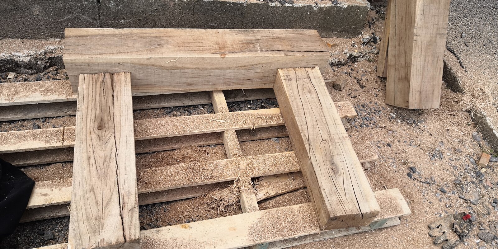

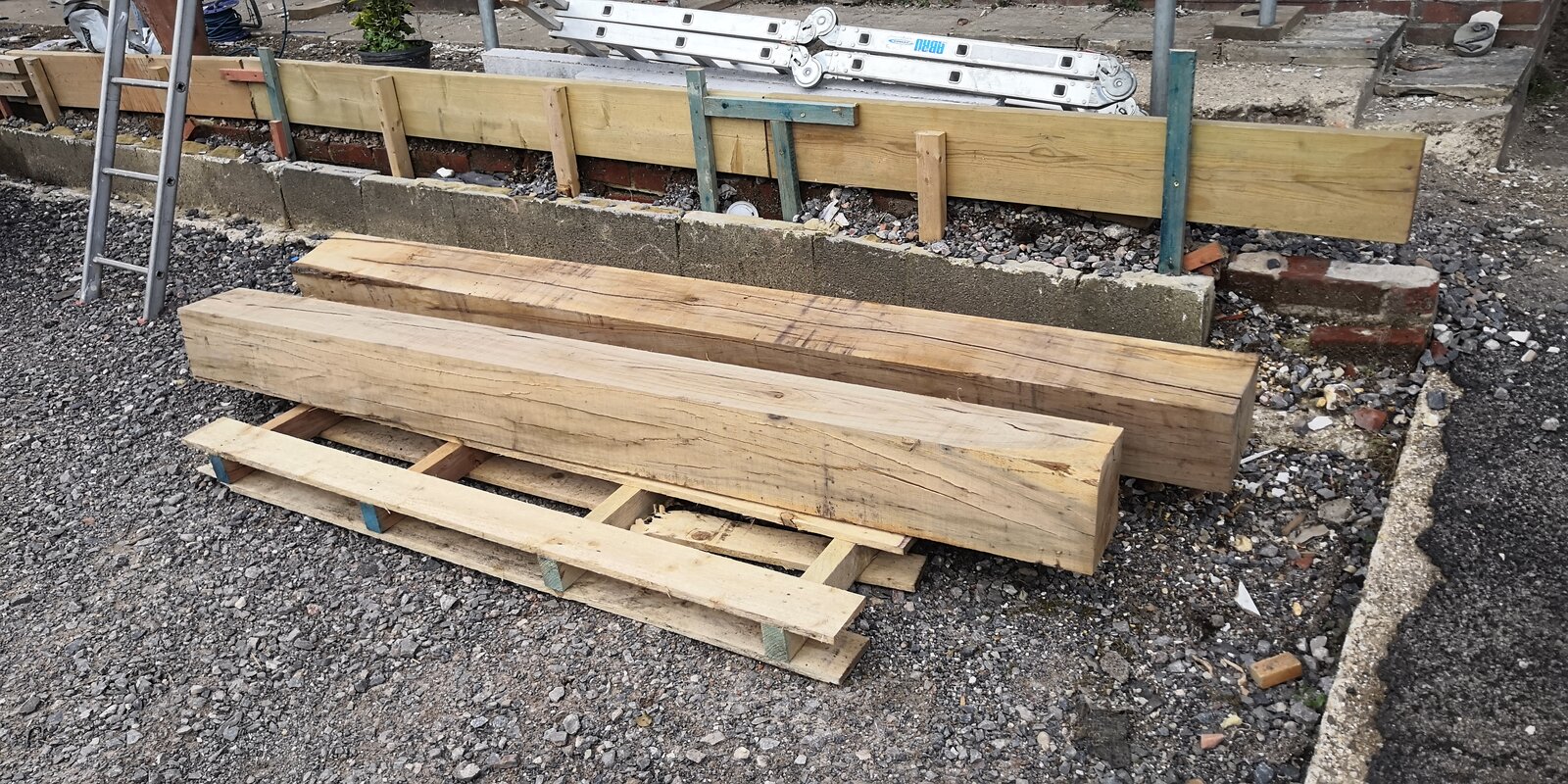

The cheapo titan electric chainsaw is great from screwfix. Need to change the oreogan chains every now and then. I cleared some trees with 18" trunks.
Had some 200mm x 200mm oak to. Cut longways so treated myself to a einhell petrol chainsaw with a bit more ommphh.
