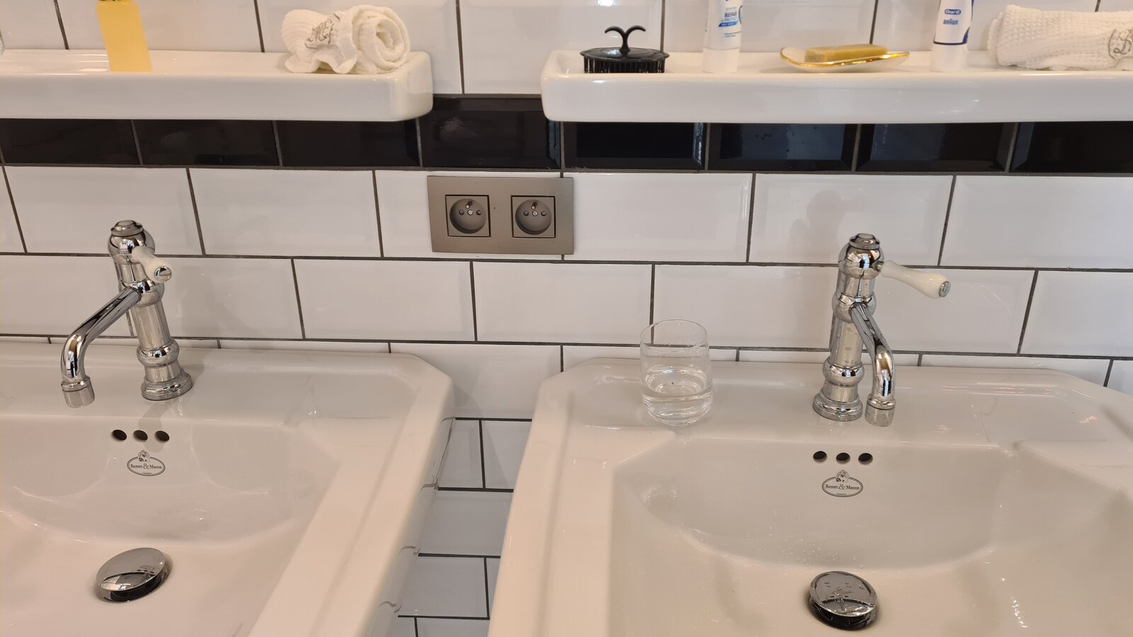

Hi, I am just curious about this and wondered what an electrician would make of it.
So last week I was working in Belgium and the hotel I was staying in had a double mains socket very close to the sinks in the bathroom. I was just wondering why this is deemed safe in continental europe but a similar installation would not be allowed here in the UK.
As I say, this is just idol curiosity and not something I'm planning to do.
Well - firstly it would be allowed in a UK bathroom if over 2.5 metres from the edge of bath or shower - basins do not count.
However, it is true that in Europe sockets are placed nearer baths and showers than in the UK .
Perhaps there are isolating transformers (I don't actually know the rules or if there is any minimum distance).
Presumably the people are not being electrocuted or shocked in huge (or small) numbers so they do not consider further restriction necessary.
The honest truth is that rules and norms are a result of messy compromises between different interests and have developed seperately in different countries. There have been attempts to harmonise electrical standards across Europe, but there has been more focus on equipment than on installations and some stuff has stuck firmly on the "too difficult" pile.

Most of Europe and some other places use a common set of standards for electrical installations, which is IEC60364.
However when those are fashioned into what ends up as BS7671 in the UK, special extra items are added including the piece where socket outlets in bathrooms must be 2.5m away from a bath or shower.
Previously 3m
Previous to that no socket outlets in any bathroom.
The exact reasons are unclear, however they will be based more in hearsay and conjecture rather than actual scientific evidence.

All continental European countries that I‘m aware of allow sockets outside of the usual zones 0-2 surrounding baths and showers. 30 mA RCD protection is mandatory.
Shaver sockets with isolation transformers pretty much disappeared when the regs were changed, in Germany and Austria back in the 70s.

I reckon that 1/ it is a good idea to keep bog standard plugs and sockets out of the splash area such as baths, sinks and basins - although there is no actual reg measure for kitchens because it would make life impossible for some in the UK. I reckon with the 3m then 2.5 m it was and attempt to remove the complete ban of sockets in bathrooms (or rooms containing a fixed bath or shower) in order to avoid encouraging hairdryers etc being used near the bath.shower . Of course some folk will still do daft things no matter what obstacles you put in the way. The UK bathroom shaver socket does go some way to reduce risks but some folks still do daft things regardless.
