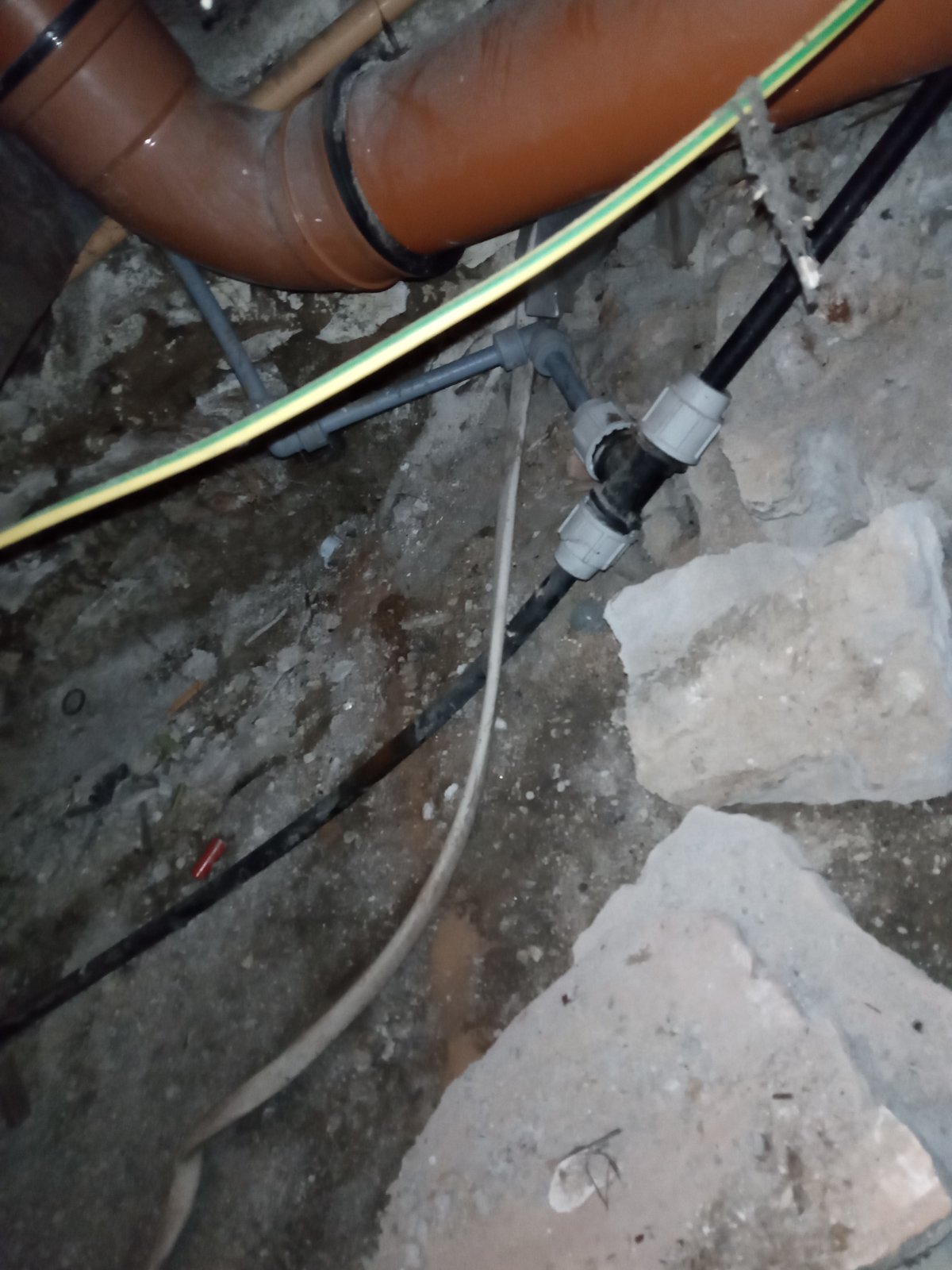

Anyone know what this pipe is? It is attached to lead that comes in from the road. Is this a standard connector? As it has grey speedfit in the spur, I'm assuming that white or grey speedfit will fit into the downstream leg, as I need to replace the black pipe downstream, as it is leaking under a concrete slab somewhere (need to reroute to fix leak). Will White speedfit (screw fix) fit in the joint when I redo it?

Looks like black alkathene, the tee should have the size written in it, looks like a plasson fitting. I’m not sure speedfit or any other pushfit domestic pipes can be fitted underground, should be blue mdpe.
Edit: if you’re connecting onto lead, there are fittings, unless you want to do away with the lead? A lot of water suppliers do lead replacement schemes, whereby you obtain someone to carry out the leg work from your property to the boundary tap and they’ll connect for free (usually).

It's under the floorboards, not underground so to speak.
The reroute will be above the concrete slab. The fitting is just before it enters the slab.
Will the JG fit into the fitting?
Does the pipe degrade under concrete or do you think there is a fitting that is leaking?
If in contact with concrete can rub on the concrete causing it to fail, if it were copper then it could corrode it.
You will need an insert to be able to put speedfit into the T.
Plasson do a couple of types of 20-15 and 25-15 ones.

Black MDPE Alkathene (it's actually HDPE) is normally recommended to be used as a temp above ground solution as it is more UV stable and as it is actually high density compared to the blue medium density, it is also more robust and stands up to more mechanical abuse. It is also recommended for use in commercial/industrial applications.
Blue is primarily used for underground domestic potable water applications.
I have to disagree with Ian H though as they are both standard metric OD sizes starting at 20mm and can use either of the manufacturers standard compression fittings. The older black imperial alkathene pipes do need adapters though.
