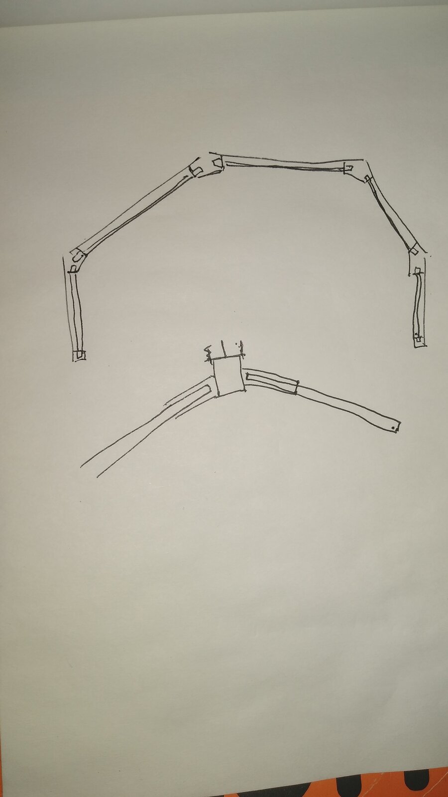

Have a 4m bay, with 4 bends
Wife doesnt like any of the off the shelf bay curtain pole kits and would like a wooden one.
Tracks are not an option, as we are wanting to remove the old plastic ones.
I can only find 2 places selling wood bay poles . One doesnt display prices, the other quote was £450.
How difficult would it be to make one? I can buy cheap wood poles and cut mitres and form the shape. Joining them will be tricky, guessing ill need to bend threaded double ended screws to the correct angle to join them.
Bad idea? Any better ideas?

I can cut the mitres, its the joining I'm seeking advice on, in case there's a better way I can think, which would involve bending a threaded metal pin to the correct angle .

At it's most basic, dowel screws might work? But you'd have to do some tests and predrill pilot holes at the correct angle. Then spin one part to the other, hopefully getting it to line up. Does it have to be invisible?
Couldn't you use screws from the rear? Plus another from the top?
If that doesn't work then what I'd look into would be creating a slot in the top of the assembled rail.so something could be dropped in and bolted up like a worktop join? Plus a **** load of glue/mitre compound
At some point the rail has to be fixed to the window frame/wall/ceiling.
Is there some way of creating brackets that incorporate the angle ?
I'd buy a bit of plastic pipe and cut it up to get some ideas.
If you want to use metal tube, there are manufactured bends that are like a bendy map light? Sort of a spring like device that stays where you want it. You could find some metal that's the correct external dimension to be a close internal fit for your tube and bend it. Then mitre, and use epoxy or a glue that I can't quite remember that works well for this sort of thing.
With a bit of imagination, this would work for wood, drilling a close fit and drilling the metal rod for a screw though into the wood.

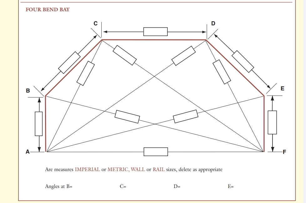

We fitted a corded track into a bay using this https://www.sg-s.co.uk/complete-sys...0-white-up-to-250cm-complete?dsort=sort_order
Obviously different lengths, bends etc. available Expensive but brilliant and works perfectly Approx £400 all in.
To measure it accurately we put a timber across the bay resting on the picture rail and I set up a pin in the middle and then with a laser measure, measured all the distances from the pin. You have to be super accurate because there is almost no give. When it arrived the bracket screws fitted exactly.
This is a case of measure 50 times, and cut once!
