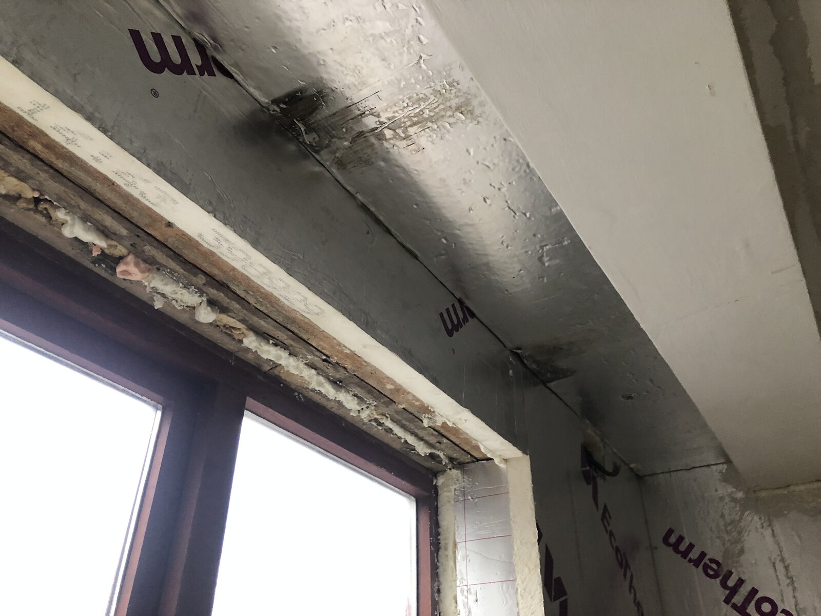

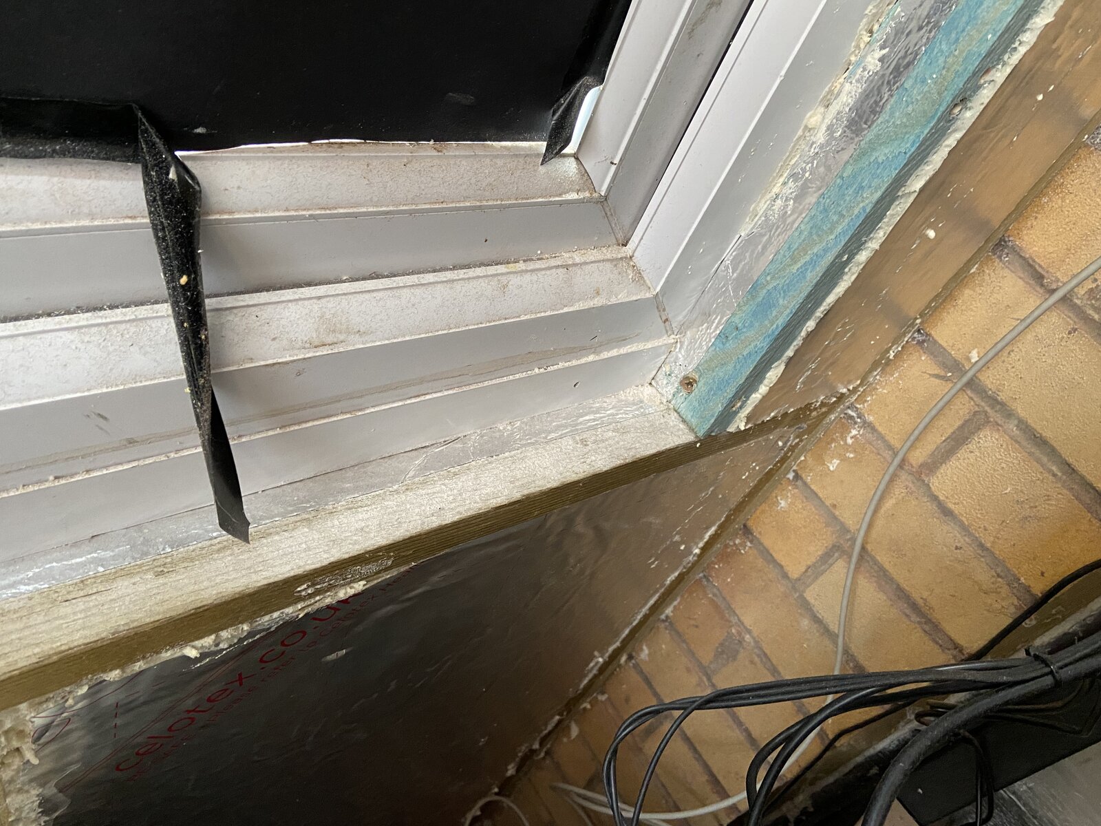

Thanks for the info. Much appreciated. If I stick 100mm of Celotex/insulation on the wall and around the window, I'm going to be "pulling" the wall out by 100mm and therefore 100mm away from the window which is currently flush with the brickwork. I've done some googling but I'm not sure what to do "square off" around the window. Just adding the insulation/plasterboard is going to leave exposed insulation around the window. Whats best to cover this? Just some additional plaster board?
44C5B1EA-0AAB-4F0B-9A54-369D1636463E.jpeg The window board may need to be either expanded or replaced. The edges of the wall are just sealed with plasterboard and filled with expanding foam if needed.

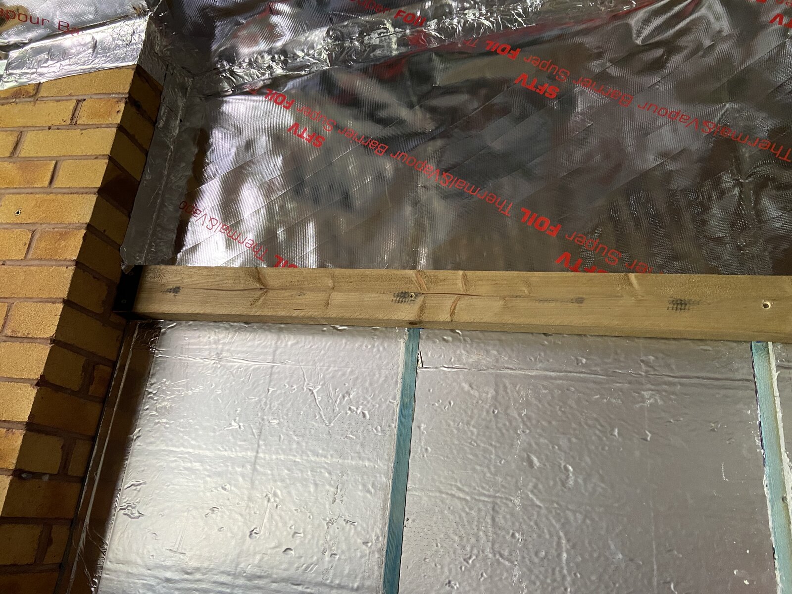

Ok, long time without updating again. I’ve finally got around to battening the external walls. 50mm of insulation between the battens and eventually insulated plasterboard on top of the vapour barrier that I’ve done some of already:
