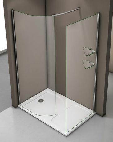

I'm contemplating replacing my bath with a shower, and I really like this one. However, there's a good chance I'm going to have to raise the tray a bit to accommodate the waste over the joists. Presumably a ply top over some battens (timber floor)
Anyway, my question is, what would you cover the sides of the plinth with? I was thinking a timber moulding like architrave so I could make it removable with a few screws to access the pipes, but maybe I'm overthinking it. I've seen tiled ones, I guess they just hope they never get a leak?
