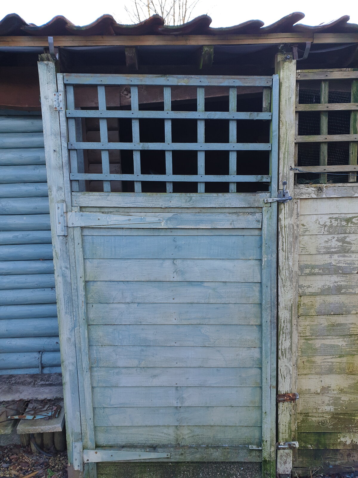

It's not really going to be that well protected - it is barely under the eaves of the garage roof. The door in the pic is the one I'm swapping out with the arched door
Set it in a bit.
Yep, can do that and keep it out of the worst of the rain but just need to make sure it's protected from the all pervading dampness that I get in this part of the world. Will look at the sealants mentioned by the poster above.
