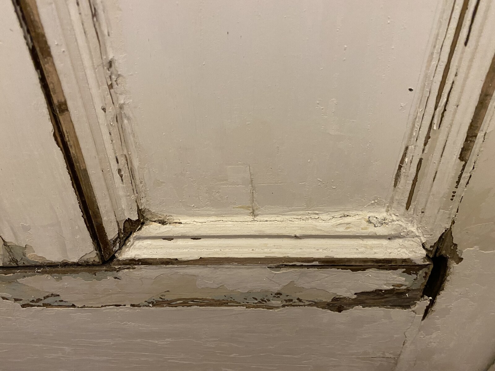

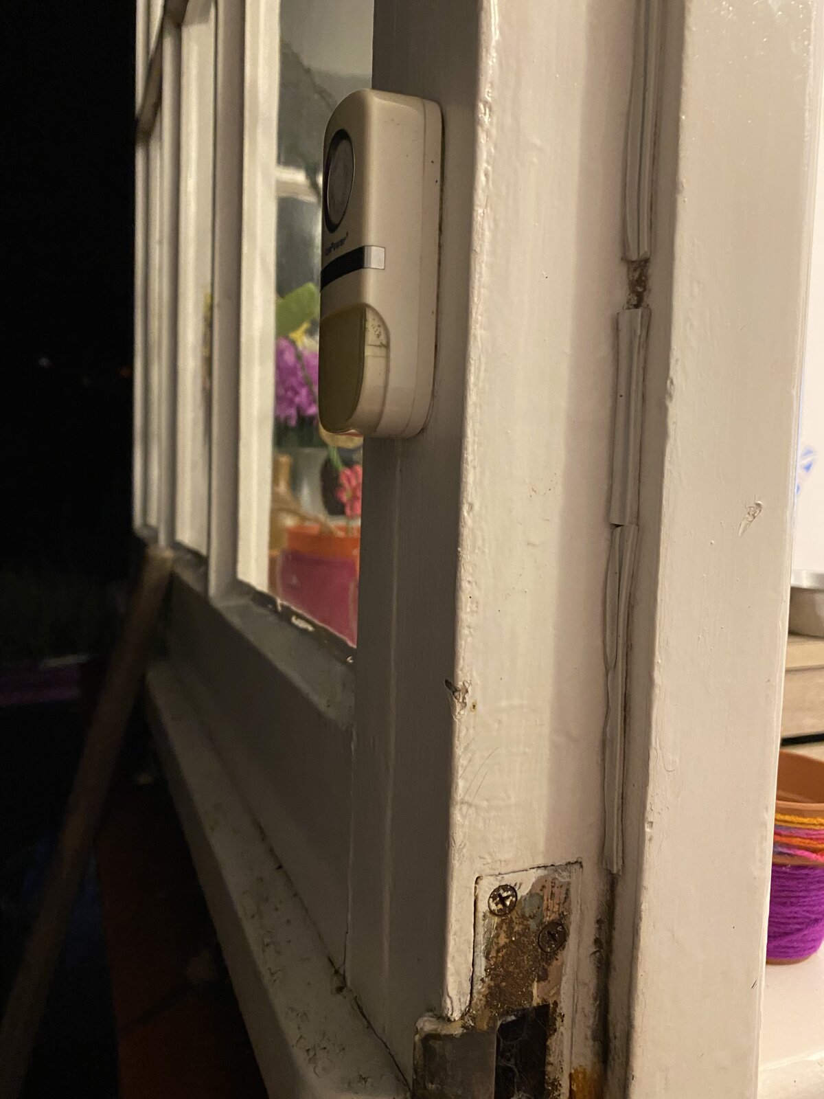

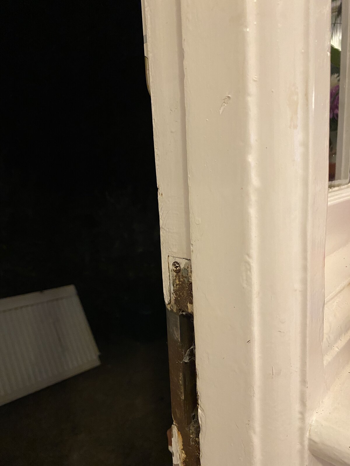

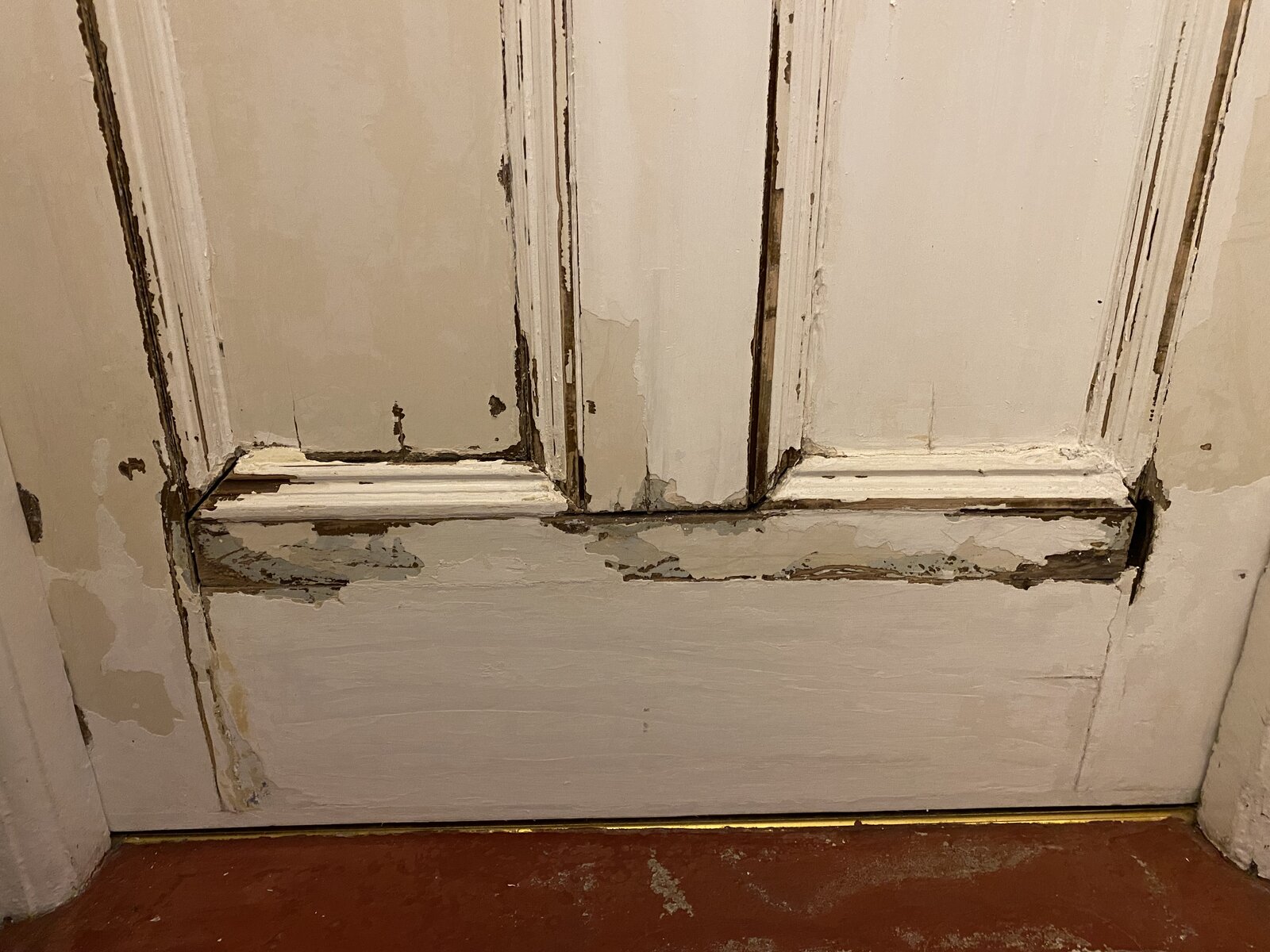

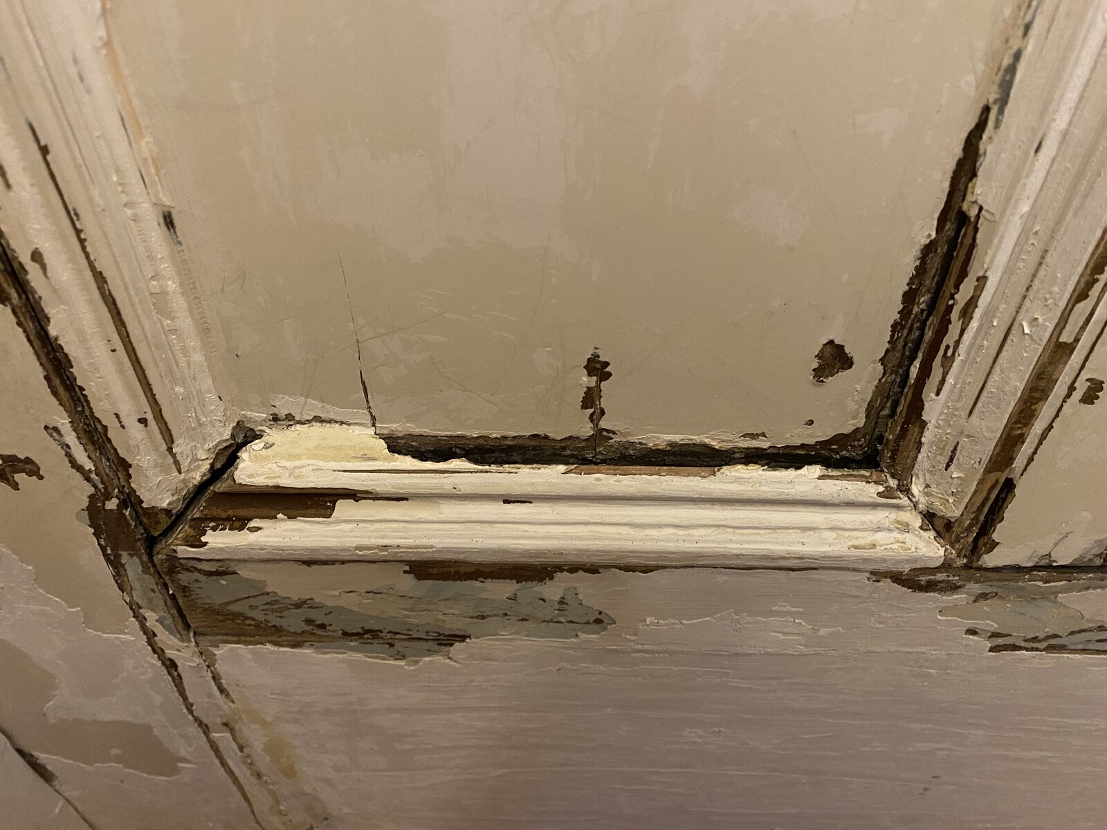

So, stiles have gone either end at the mortice into the bottom rail; and moulding at the bottom of both panels is ropey. Plenty of filler about. That's internal; external is a bit worse. I added a couple of pics of the frame/jamb/stops for context.

At first sight that looks reasonably repairable. The mouldings can be replaced, maybe not with an exact match, but possibly something similar and in keeping. The panels I'd like to see once the mouldings were off. The muntin not meeting the bottom rail may be fixable by just reglueing the joints and clamping (6ft sash cramp). In fact the only two things I'd query are the state of the bottom rail (that hole doesn't look too healthy) and whether or not the door has visible signs of wet rot (have you tested it with a small screwdriver?)
The very base of the bottom rail is soft in places with my fingernail test... that hole would probably go all the way through to external if I gave it a push ... otherwise it all feels fairly solid other than the bits in the photos above.
Sounds like you might be able to get away with just replacing the bottom rail and possibly treating the bottoms of the stiles wiyh wood hardener and maybe some 2-pack filler
