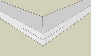

Hi all. I want a framed mirror of a certain size and look to go in a certain spot, so thought i'd have a go at making one. I dont have a router so i thought i'd get the depth by using some trim [20x8mm] around the edge.. mirror glass butting up to this, and a ply backing. What i'm wondering now about is what might be the best/most convenient way of putting the frame itself together.. i have wood glue and small panel pins, but no large clamps.. and even if i had long clamps i imagine the mitres would be slippery buggers to hold until they set. I remember seeing some metal corner brackets that you could screw in the back, i guess you could just glue the corners, screw those in, then that would be solid enough to knock a pin in, or would do as is.
Anyone know where i could get those, or have some more idea's for putting it together?
You could always use 2-part "Mitre Mate" glue to hold the corners together - sets in 2 minutes. I'd consider adding a diagonal saw kerf to each of the corners and then glue-in triangular veneer "fillets" for extra strength:

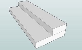

If your frame has no rebate, how do you intend to hold the glass in? That's what the rebate is used for. If you don't have a router it is possible to produce one by gluing two pieces of timber together, thus:
To hold the timbers together whilst the glue dries, use masking tap to bind the pieces

I'm not much good at this sort of thing, but given the difficulty of constructing a mitre with any strength, I was thinking you might put the glass mirror on a piece of ply, then fix picture-frame edging to the ply, with the glass held in the rebate?
Hi m8, i was gonna do exactly that, add trim around the frame edge to give a rebate, 20x8mm strips. I like the kerf idea, but all my saws are probably too coarse.. where would u get the fillets, or would you make em? That mitre mate sounds like good stuff too, will see if i can get some.
Hmnn..thats a good idea JohnDexcept that i was thinking it'd be best if i tacked the trim onto the frame timbers and cut as one piece to get clean mitres.. i can imagine it getting messy if i try to do them seperately... thinking as i type.... i suppose i could do what i intended, but tack 3 sides on the way you describe, slide the glass in, then only have a top piece to glue/fix, which would be a lot easier. Might be a problem with the filler getting in the way there.. the 20x8mm im using to make a rebate will leave a 2mm gap behind the glass and i had thought to use draught excluder or something as a packer.. might be ok though. Would that work or is there something normally used that better fits the purpose?
edit : i can tack the trim and frame members together lightly just to make the cuts then put it together back -> front as u suggest.. for packing the glazier let me have a load of those sticky corkpads they use which work out just right :)
