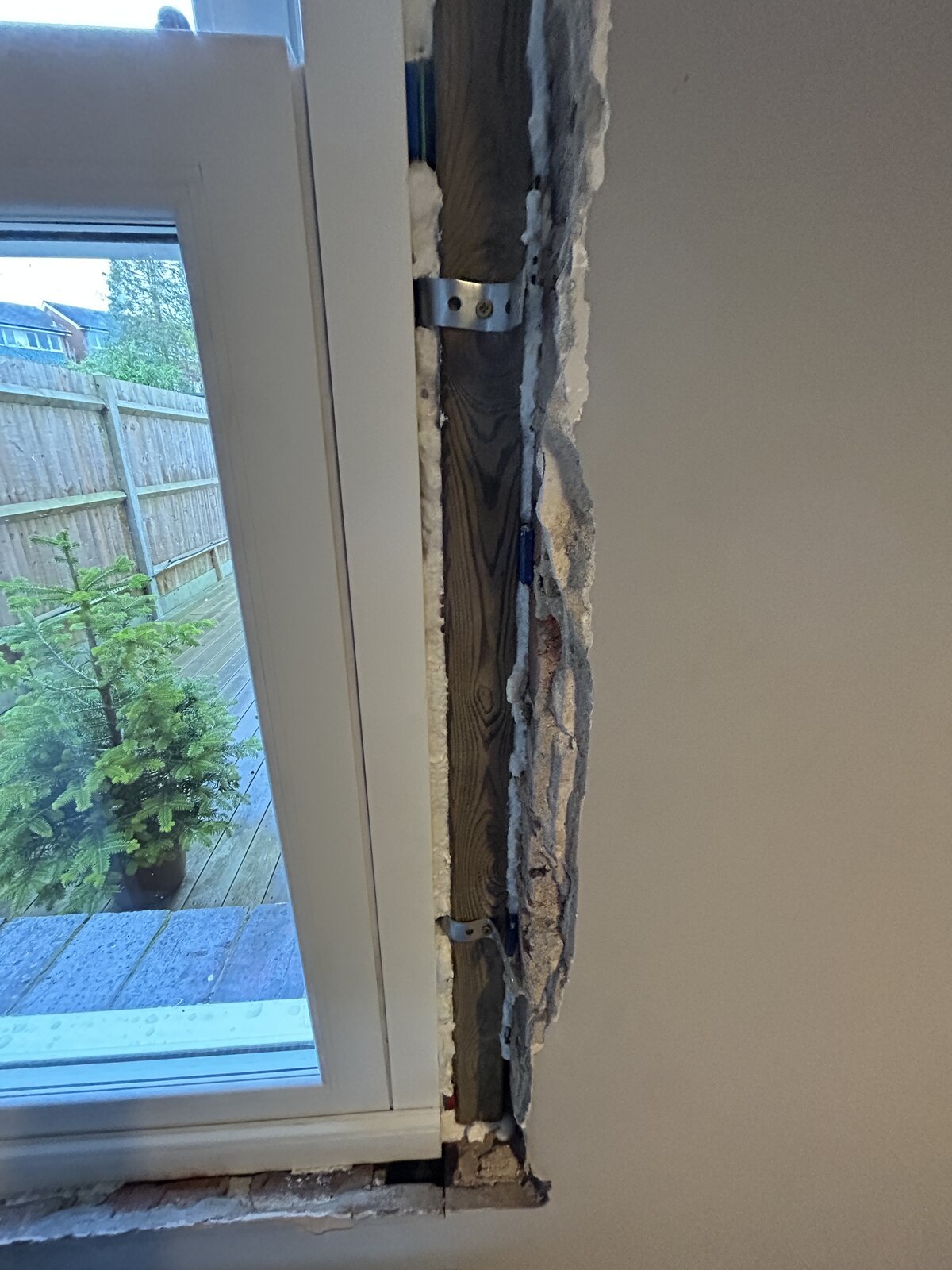

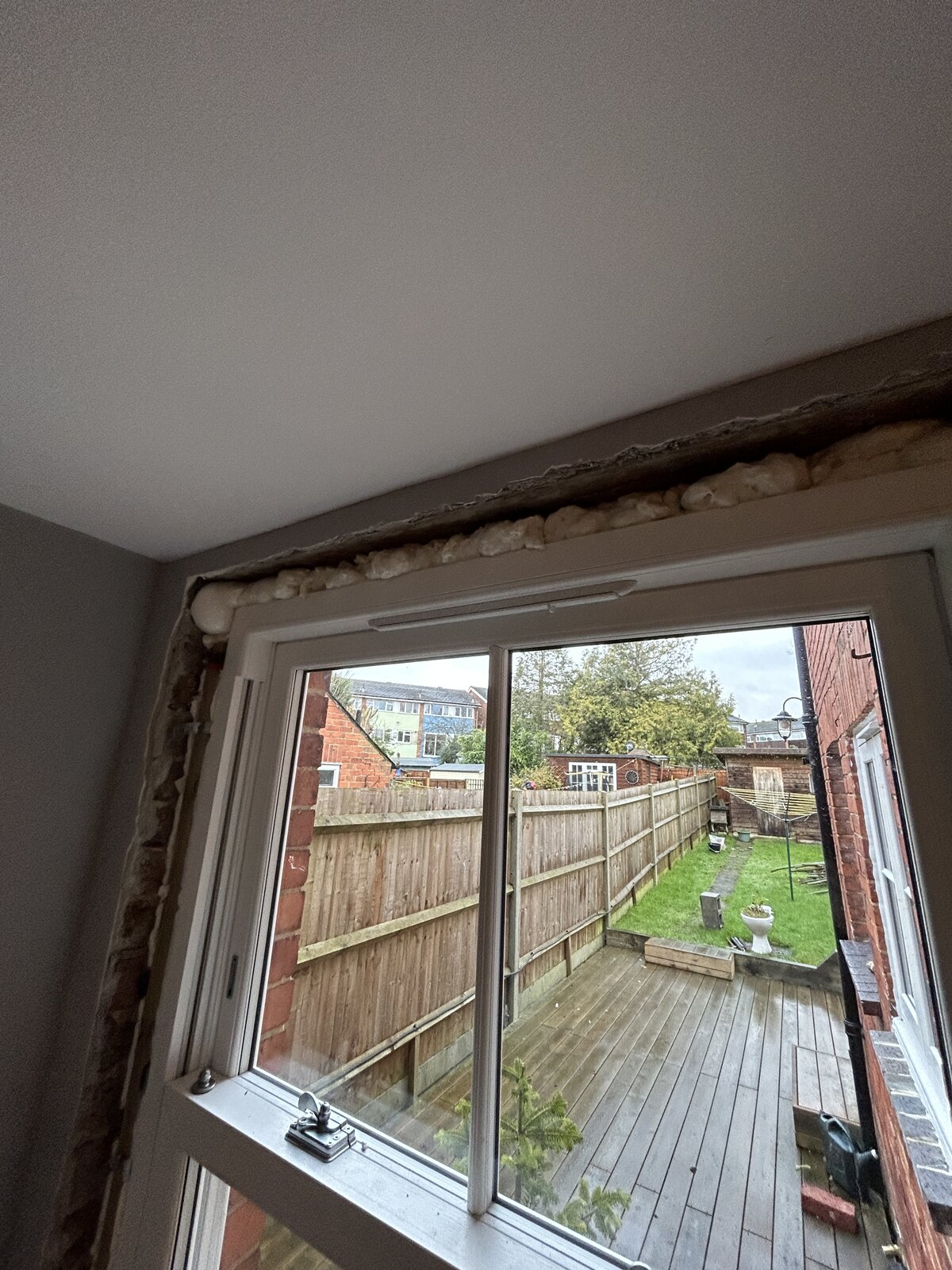

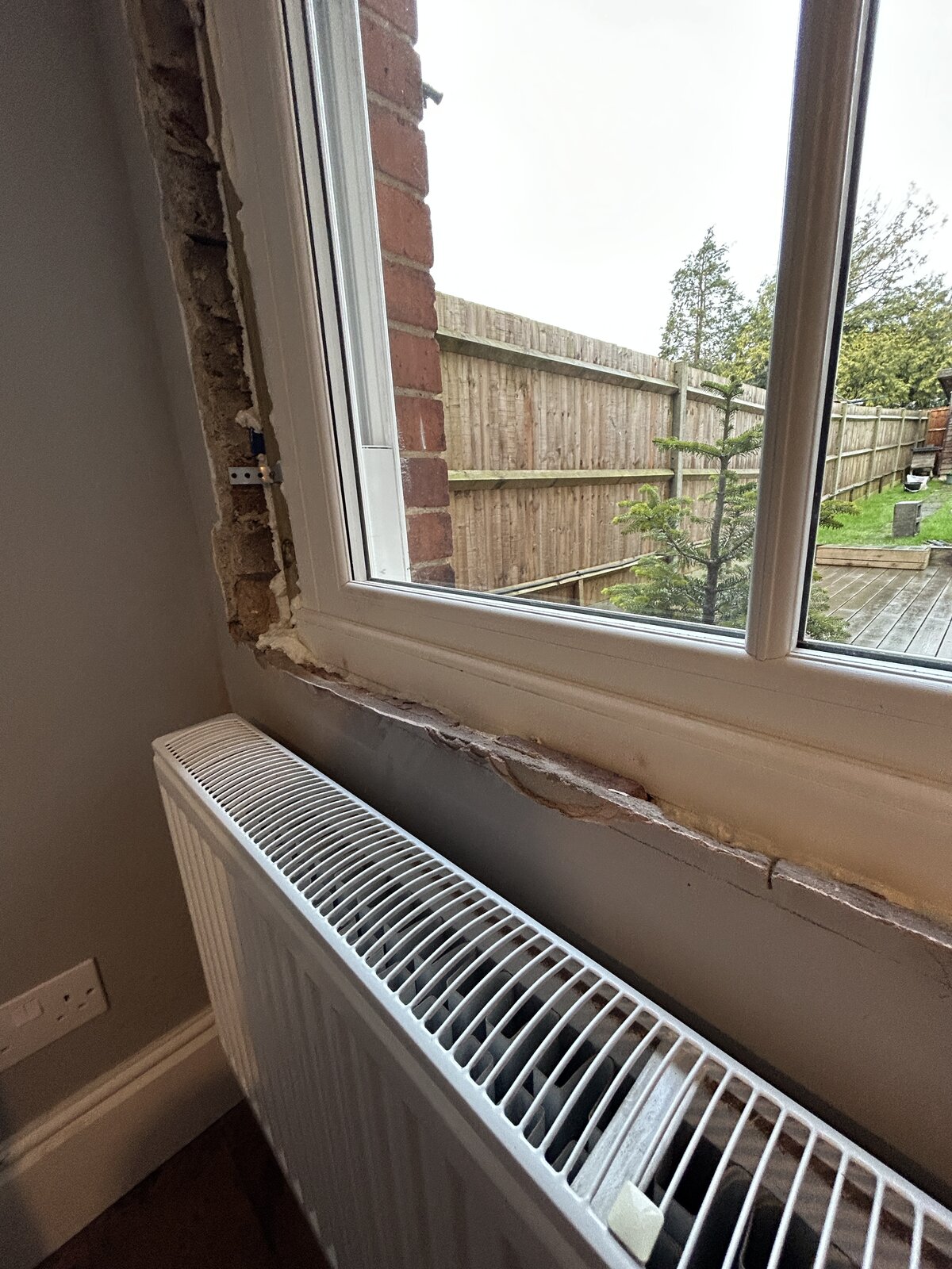

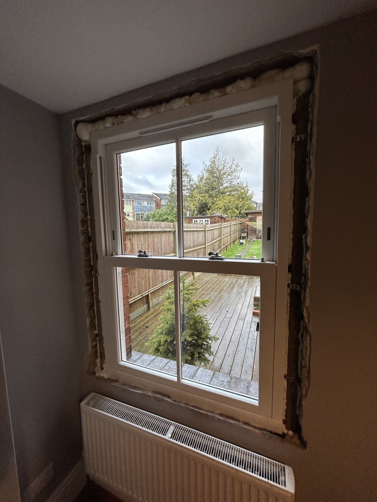

Morning. I recently installed new windows in my house. I need to make good and I’m looking for ideas on how to do it photos attached.
Thanks. X

Screw suitable timbers up the sides and a header timber for the top to leave them 15mm shy of the wall surface and then fit 12mm plasterboard so you have around 3mm for the skim finish.
