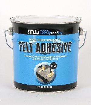

The ready-made alternative i can find in the shops is a cold adhesive but only comes in 5 litre cans:
