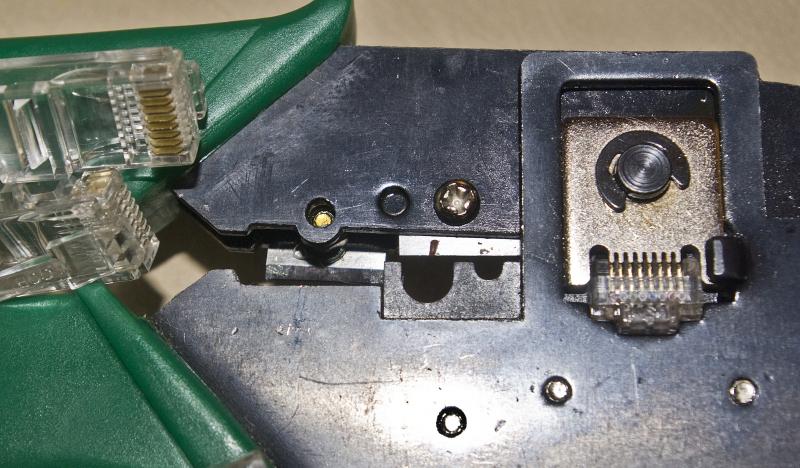

There are numerous problems with cheap toolage for 8P8Cs. Many of them need to have the die aligned properly before they'll work right.

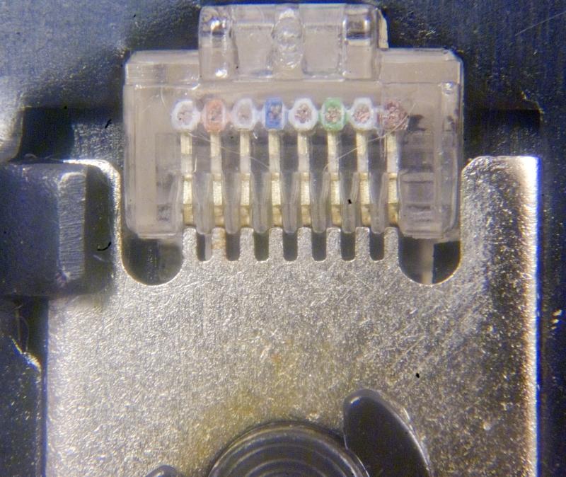

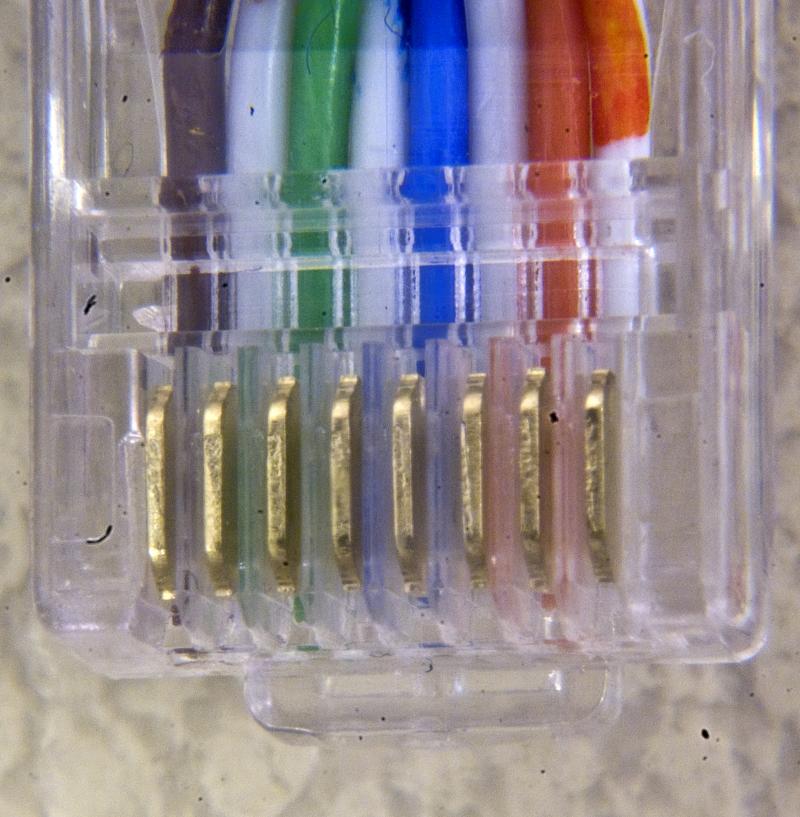

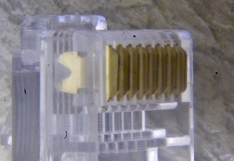

I think I may have found the mistake. I had thought it was 12 pair, 34 pair, 56, pair and 78 pair however it seems 36 is a pair and 45 is unused pair which explains why a single plug replacement did not work and why long cables did not work as the impedance of the 36 pair would have been well out. However on replacing the plug I still was not getting it to work so here goes with pictures.
is general picture and shows type of pliers and
shows close up on unused plug shows the cables in the plug and shows the pliers on plug but the light was not too good so needed 30 seconds exposure time with about +7 close up lenses fitted to the standard zoom lens. In hind sight should have increased the ISO rating and if you can't see what is required if not I will need to set up some lighting I can zoom in more if required full frame of about 3mm is about the limit with camera after that need microscope and not sure if there is enough room to fit plugs under the microscope.
To me all seems OK and I will admit I can see more with pictures than I could with naked eye. So what do you think?
Those 8P8Cs are for solid wire, so it's possible you're not making proper contact with the wire.
I can't really see anything wrong with the work, though, except it looks like some of the wires are slightly short in the third picture.
