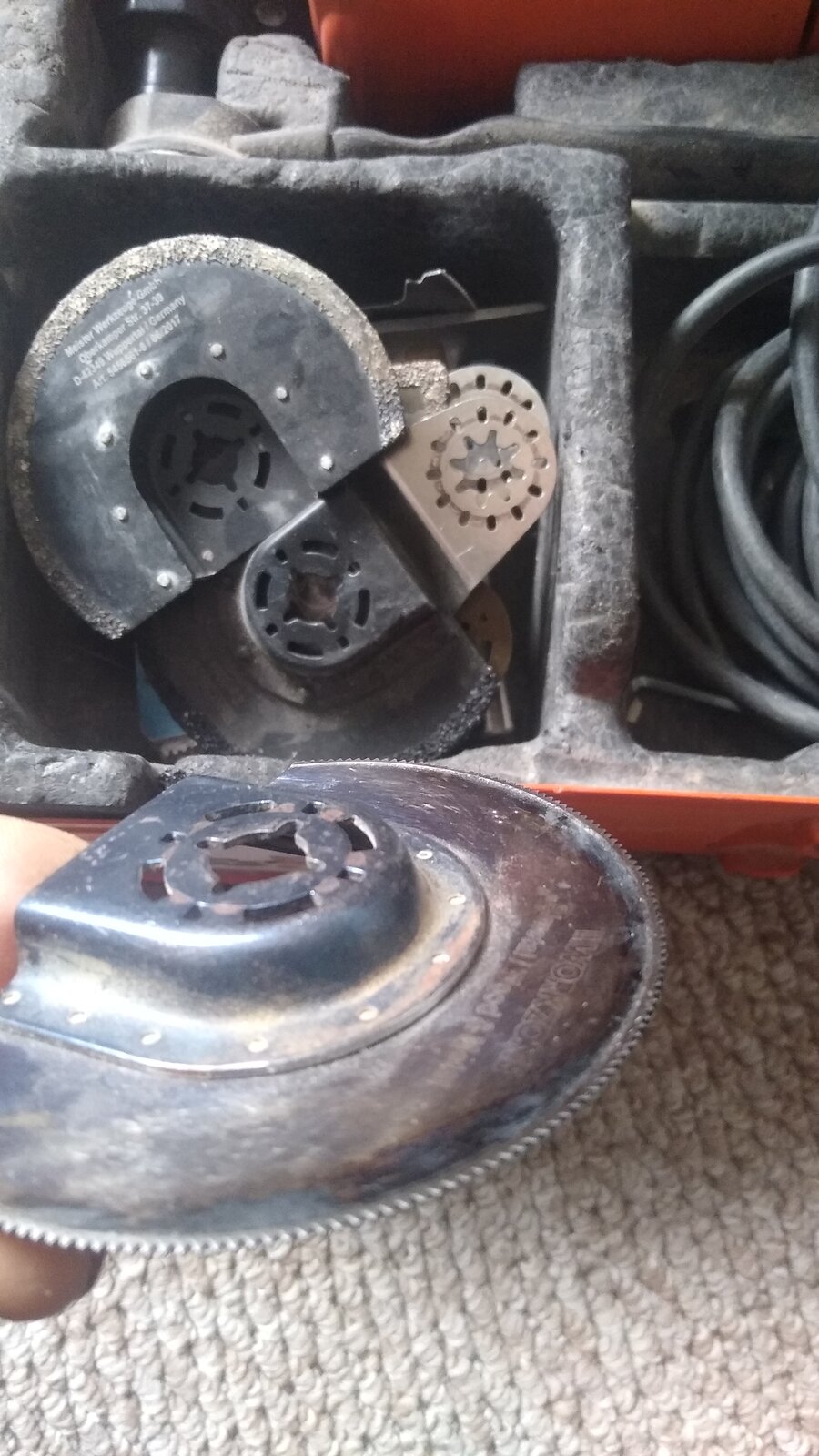

I need to lift a load of tongue and groove floorboards and I already have a few LXT tools so i want to buy a compatible multi tool for the job, but i cannot find a Makita branded depth stop. I don't trust myself not to go in too deep and potentially catch a wire or pipe Every other brand appears to make their own depth stop. Does anyone know if there is a Makita branded/compatible depth stop?
There are blades with depth scales marked on them. Or just use a piece of brightly coloured electrician's tape wrapped roundcthe blade or a Sharpie marker line. By every other brand I have to assume that you mean Festool and Fein - never seen a depth stop on other brands (but then, I have both a Festool and a Makita, and don't really see much of a need for a depth stop)

Some semi circular blades will bottom out on the mounting boss, the lidl and aldi ones do at 18mm which is useful for chipboard floors.
yes i have a box full off them as well as grit edge and sanding pads all the ones never used :giggle:
