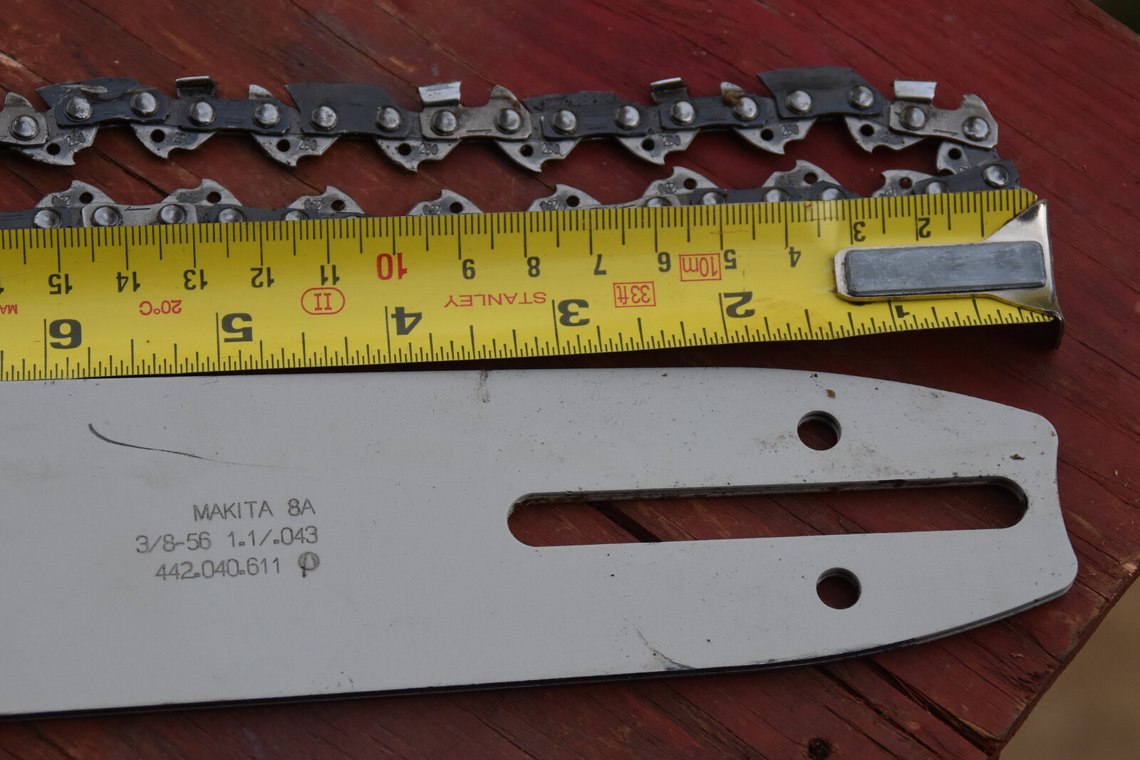

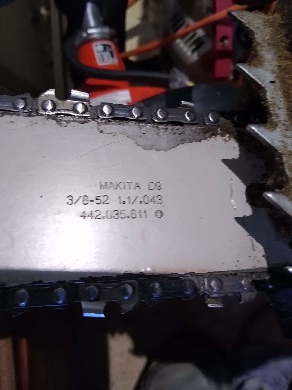

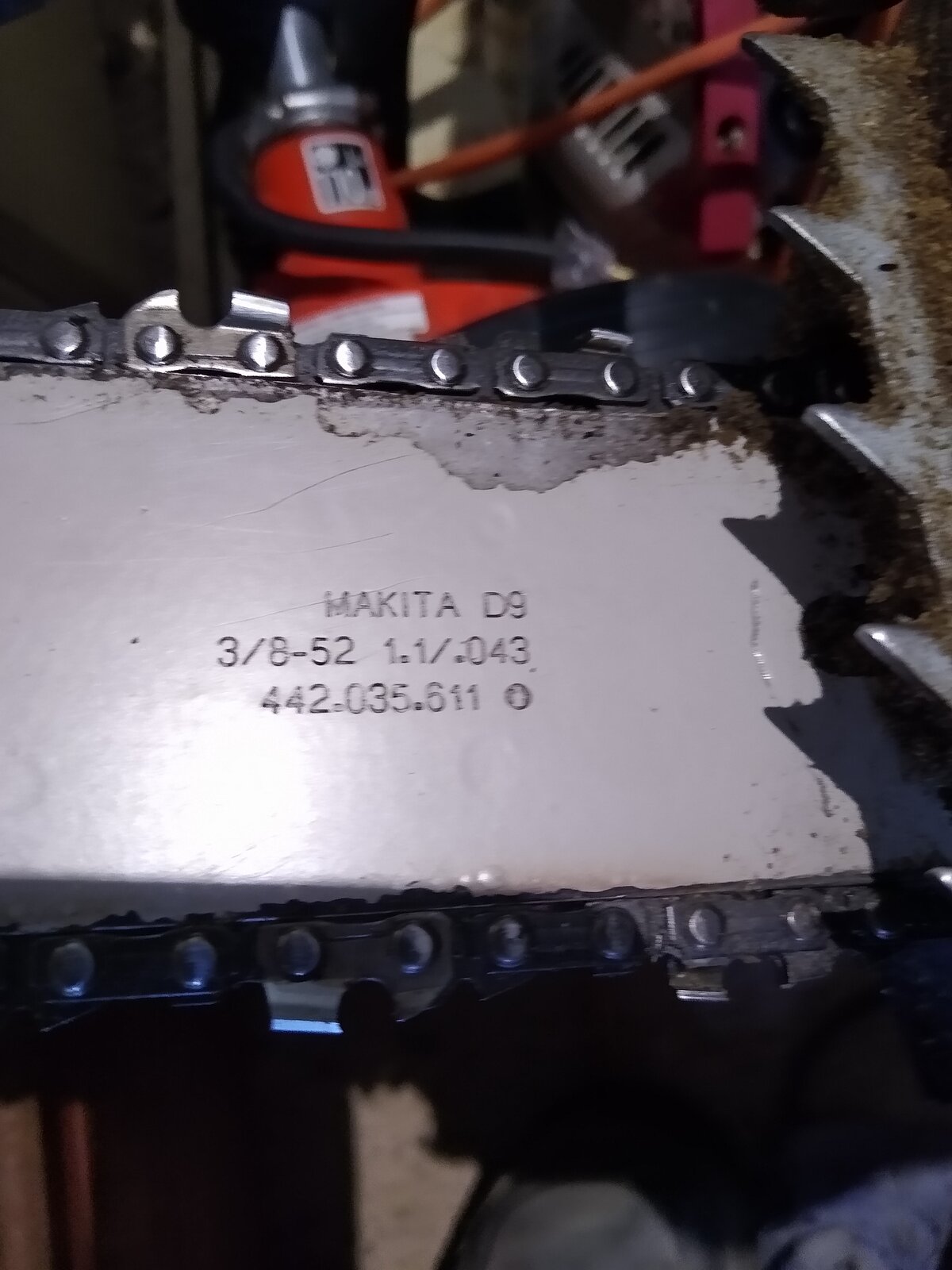

Take the details stamped on the bar near the body of the saw and search online. IMG_20220417_092257475.jpg

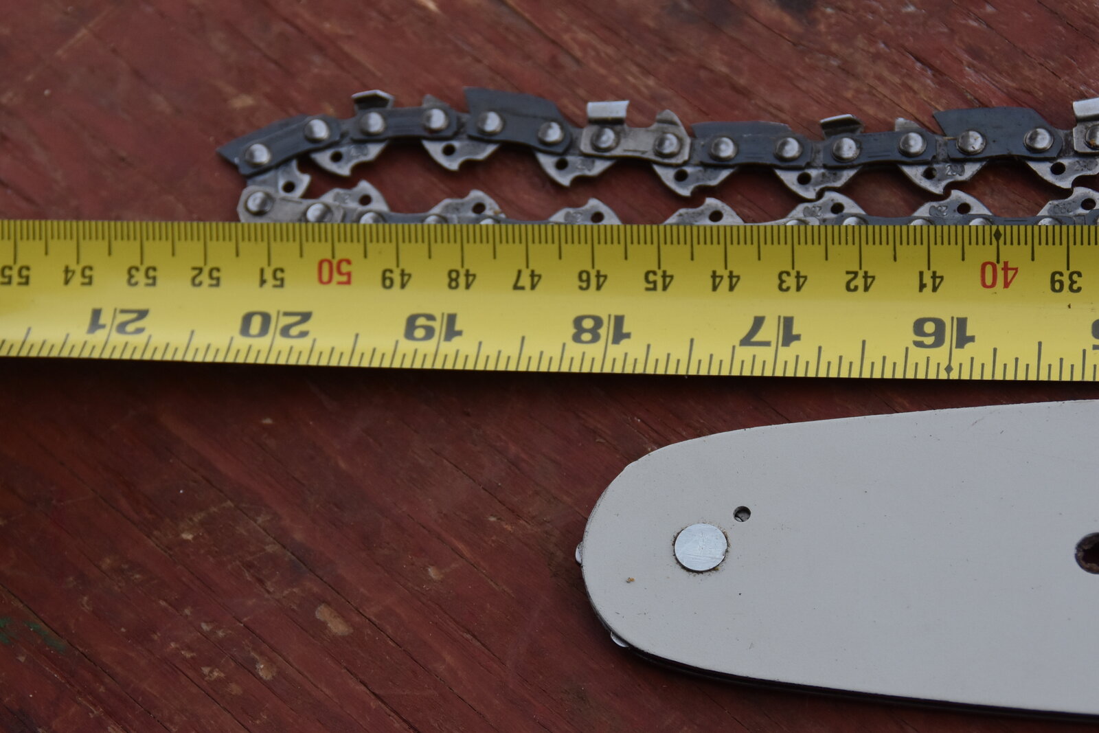

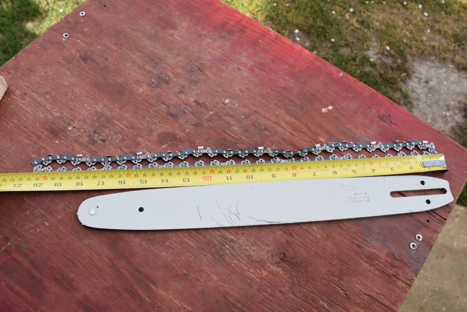

@pidgeon1 looking at the top of the bar, the teeth should point forwards as shown in the photo posted by 'lostinthelight' higher up.
In his picture the teeth are pointing towards the left, above the stampings. The curved shoulder on the left side of the link is a guide. The tooth is the 'shiny rectangle' to the right of it.
Video shows my model chain bar the same. Chain Saw 1.JPG Chain Saw 2.JPG Chain Saw 3.JPG Don't know if previous owner has change chain at some time or it's original.
