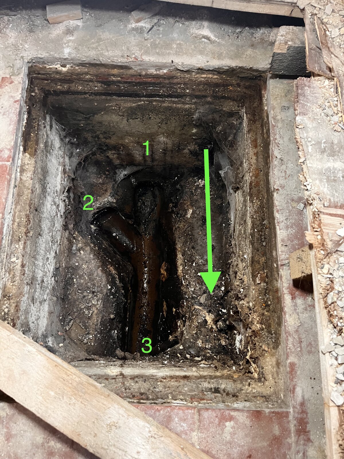

My mother in law moved in to a new property and we discovered what appears to be a shared manhole when we lifted the floor!
do we need to contact Thames water and ask them to confirm ownership ? and if they say its their's then what do we do ?

At the absolute bare minimum cowboy least, the lid needs replacing with an air-tight one.
Pop it up and have a look, it looks like a normal inspection chamber, not an opening to another dimension.
Sewers are usually surprisingly clean looking, often just water unless it's backed up. Give the bog upstream a few flushes with a bit of bleach first to avoid any frights.
You never know, it might be disused or your own private pipe.
I must say that I'd be interested to know the outcome. On that point, where does it go to?
so mystery solved for anyone interested, image below
1. turned out to be the waste from the bathtub/shower upstairs 'no waste from neighbours'
2. toilet waste
3. next door neighbour 'goes under his extension!'
we got a builder that will relocate this to be on the side of the property, reconnect the soil pipe and make connections for kitchen etc

yes it turned out to be private, on that note. although the manhole did not open up an access panel to another dimension lol it was suprisingly full of spiders and cobwebs, I don't even understand how they got there let alone what they are feeding on...
