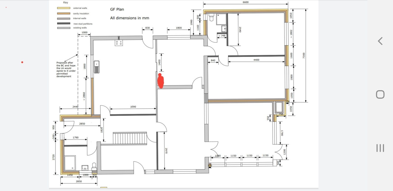

attached is the ground floor plan of my house. some of it suspended timber floor and some is concrete floor. we have decided to install under floor heating system. can someone please let me know the best position to fit the manifold. I am hoping to use one manifold.

If you can get away with one manifold then it'll need to be central, such as where I've drawn a red line/splodge
I really think you'd be much better off with two though. If you're going to go to the expense of UFH, it's better to do it once and do it right

I agree two is much better. any recommendation of which type or make to use. I have been searching in eBay and there are so many variations. I am also looking for one with mat for fast and easy pipe installation.

For that size property only use 1 manifold. It’s way too small to use 2 manifolds.
Ideally in the centre of the house but you could put under the stairs. Any flow and return sections from the manifold to the specific room should have a corrugated sleeve slid over to stop heating along its route, and through each door way to stop problems with expansion.
