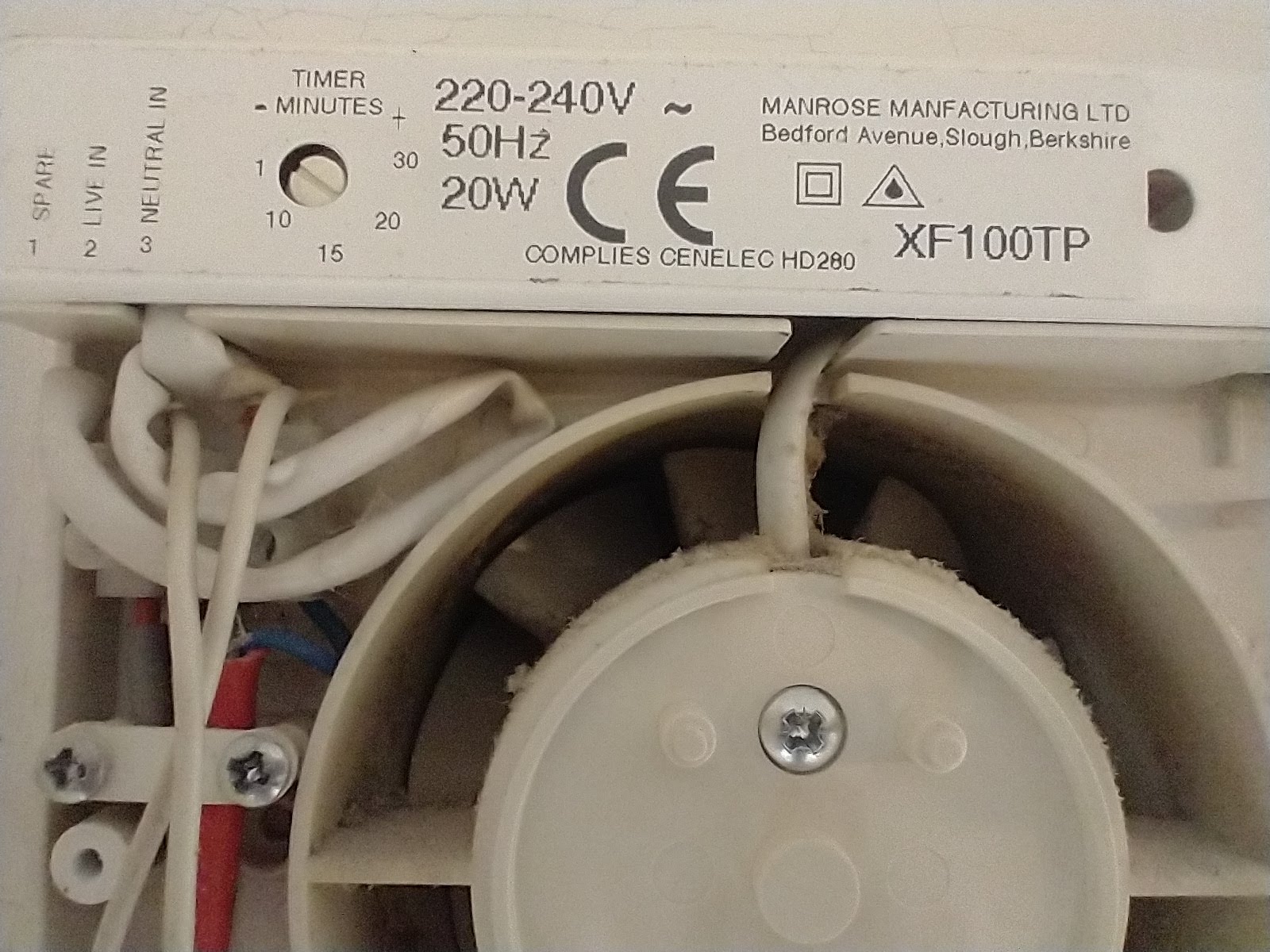

Old model XF100TP:
- 3 connections on the connector block: 1 = Spare, 2 = Live In, 3 = Neutral In (but 'Spare' seems to be connected to something, maybe the external pull chord?)
- Has no internal pull chord.

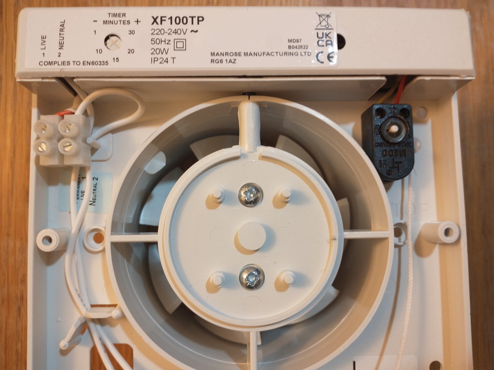

New model XF100TP:
- 2 connections on the connector block: 1 = Live, 2 = Neutral
- Has an internal pull chord
Any ideas whether the new one can be connected up like-for-like, or is the newest incarnation of the XF100TP annoyingly not identical to the old one?

Old Fan: (3 terminals in the connector block, no internal pull chord)
New Fan: (2 terminals in the connector block, with internal pull chord)

I don't see what the functionality is supposed to be, but I guess it won't be coming on just because you turn the light on. I guess you wanted the XF100T (if you wanted light switch operation, but maybe you didn't).
Is it that on new one, the timer works after the integral pull-cord is switched off?
If so, then could it not be rewired to work with the ceiling pull-cord?
Perhaps that is what someone has done to the old one.
I just don't know what they mean by 'pullcord override switch'. As though it did something without the switch.
