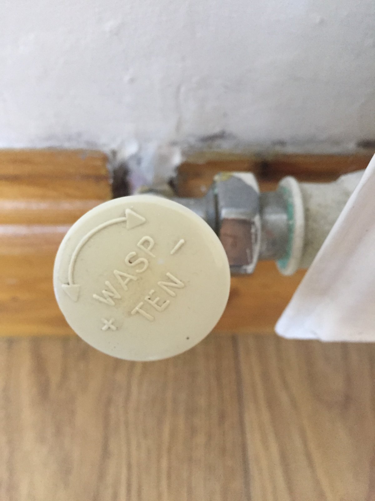

Hi,
My radiator is leaking from under the plastic cap (one that has a + and -) and turns the spindle clockwise and anti-clockwise).
When I try to turn the value off it leaks even more.
Can I remove the cap? I’ve tried but it doesn’t seem to move and I’m scared that I will do it wrong. I thought they just pulled off so you can get to the workings underneath. Am I right? Any advice would be so appreciated.
That type do usually pull off wear a glove and give it a good hard tug, without the glove you will almost certainly take a chunk out of your knuckles when it comes loose! You can prise against the bottom but they often shatter if they are old. Underneath you will find a spindle tighten the nut surrounding it.
Hold the lower valve body and give the plastic cap a good tug,they need some pull apart pressure. they are basic valves and can leak water if turned.Maybe consider exchanging all the wasp branded valves :cool: or leave them alone. :arrow:
Use a pair of grips, and pull straight up. Some caps are very brittle, but I woud bet that that one will be okay. Once removed, tighten the gland nut in a clockwise direction

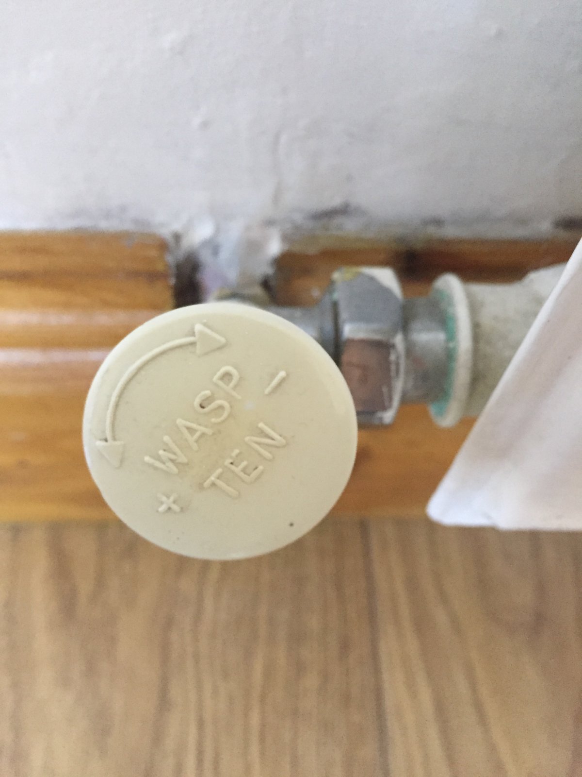

Hi,
