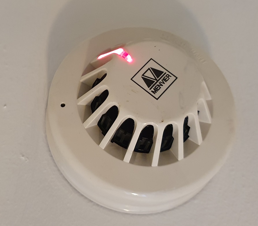

Hi all,
I got an alarm system in my house, and this is a smoke alarm connected to it. It got triggered when I sprayed air freshener under it. I acknowledged the alarm on the main board by entering my PIN. However, this red light has not gone off. How do I get rid of this red light? I don't have the manual of this product so don't know how to reset it.
Any advice please?
Twist the head of the smoke out of the base or try to set the alarm as it may be programmed for detector reset ...
