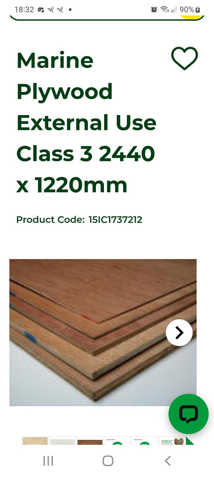

Is this reasonable, Class 3?.
I don't mind paying for something that will last to be honest.
Maybe treat it as well?.
I'd prefer to stick with plywood as the first lot was excellent, held the weight very well and lasted a long time.

WBP "water and boil proof" shouldn't delaminate. It can have soft layers though. At least the outer ones on Marine are hardwood of sorts.
@JobAndKnock will know.
Ah - found this. Clsas 3 looks OK.
from one supplier:
To what quality specifications do we qualify?​
Our plywood is compliant to EN314 and EN636.
Plywood has two material components, wood and glue, EN314;1993 and EN636;2003 are standards that work in tandem with each other with EN314; referring to bonding quality and EN636 referring to the durability of wood species.
EN636 defines the specification of plywood regarding the type of glue, the durability of the timber and its suitability for structural use.
The number following the EN636 code defines the durability of the timber used in the manufacture of the plywood
EN636 – 1 (Class 1) Defines product that is suitable for dry interior use only
EN636 – 2 (Class 2) Defines that the product contains timber that is classed as non-durable and is suitable for use in humid areas or exposure to occasional wetting. It can be used in the exterior application when fully covered or given a fully external decoration.
EN636 - 3 (Class 3) Defines that the product is made from timber that is durable (hardwood throughout) and is suitable for all exterior application including frequent wetting. Prolonged use in an external application would require boards to be covered or decorated.
The final part of EN636 deals with its suitability for structural use. All the plywood we stock of a thickness 9mm or over is suitable for structural use and is defined by the addition of the letter "S". Boards below 9mm show the letter "G" in their description and are only suitable for General use (non-structural)
