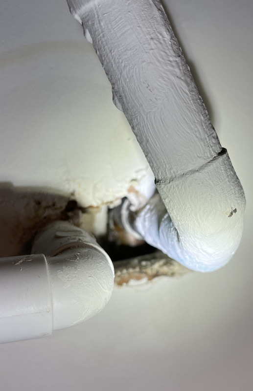

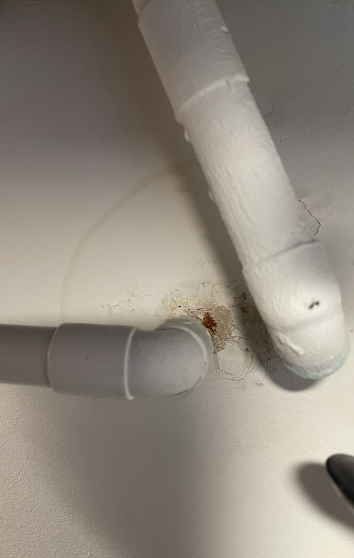

Hi, I live in a four year old new build.
I noticed this morning whilst checking the pressure of my boiler that under the boiler, there are two pipes which go into the wall from the base of the boiler. There are now visible cracks in the pain to the side and above the two pipes as well as a strange mark in the shape of a circle in the general area.
I have touched the wall and it does not seem wet, I can find no leaks or dripping anywhere, all pipes are dry.
Is this anything to worry about?
If they are heading outside, I'd check to see if the external pipe's are sealed to the wall, that may be moisture ingress.
Thank you, I will check that out. As far as I can see, there is only a boiler pressure overflow pipe outside, but I will check that out.
Is that a drip of water on the right hand pipe?
Well spotted, no, dried paint, I thought the same as you when I first investigated it, but dry as a bone.

It looks more like a condensate pipe from the boiler, but I am not a plumber...
The 15mm copper pipe is the pressure relief pipe, from the PRV inside the boiler.
The 21.5mm plastic pipe is the pipe which carries the condensate away from the boiler, normally routed to a drain, but not always.
The cracking in the plaster looks like shrinkage from a rather thick layer of finishing plaster, (to fill the hole),nothing to worry about.

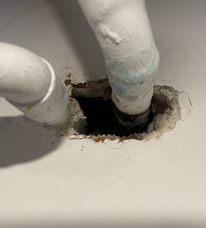

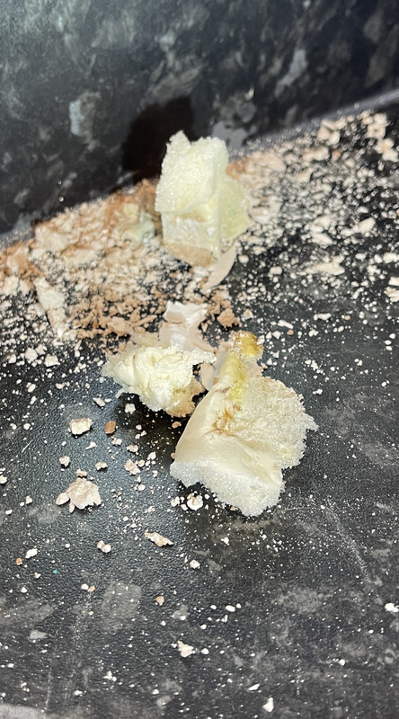

Update: I have cut around the pipes, I found that the right hand copper one seemed wetter in the plaster. As you can see below, the plaster is mainly dry, just a very small amount of moisture which I am guessing has accumulated over time. There was foam just under the plaster, so I think maybe when the house was built, they filled the gap with foam and then put a bit of plaster on top.
Both pipes go into the wall and then go down towards the kitchen floor, they don't go up which is strange as based on the markings on the wall, you would expect maybe something was dripping from above in the pipework, but that is not the case.
As the pipes drop down, there is a piece of metal between the pipes and the plasterboard, maybe to protect them in case you were silly enough to drill into the wall below the pipes? I have removed as much plaster as I can before hitting the solid parts that would not cut away so easily.

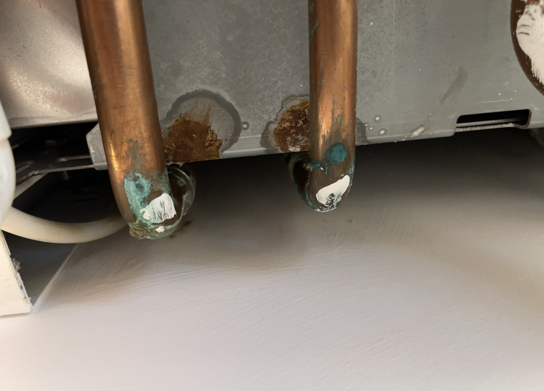

It seems that the copper pipe is not pressure relief but actually the gas line into the boiler. That would rule that out of being leaky which would mean it must be the condensate one on the left.
I checked again this morning and everything is dry. I have stuffed the hole with kitchen roll and will leave it for a few days before pulling it back out to see if it is wet. So far, totally dry.
You may find then that it's condensation then and not a leak. The condensate water is warm and when it hits the cold cavity moisture condenses on the pipe.
You are correct, that is the gas pipe, the plate will probably be there to stop accidental damage as you suggest. FYI There are certain regulations that cover gas pipes in cavities/voids, hopefully the gas pipe has been boxed in correctly (size of void). Do you get your boiler serviced yearly?
