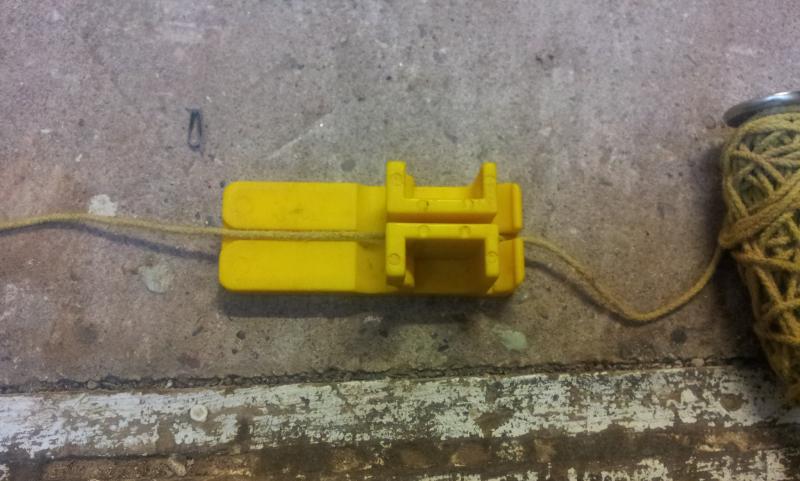

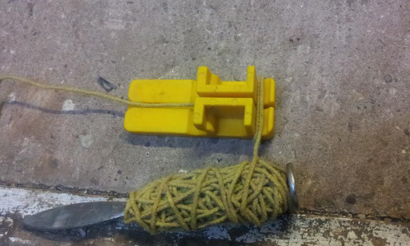

In your picture, push the top one over so it flat, then the line runs down the middle, and out the RH side and then you wrap it around the thick section
Sit the block on the corner and the line will run along the brick arris

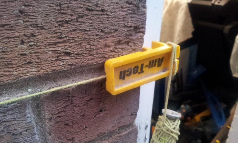

No that is wrong
The block goes on the side of the brick not the top, but more importantly it goes on the side between two courses of brick and effectively in line with the mortar joint, and you tweek it so that the line is in-line with the top edge of the brick
Also the line runs down the middle of the block, not as you have it on the edge

The line should run down the groove in the centre. It's wrong at the moment.

Here we go .....
Block with line through it
Line through block and wrapped around end
On wall
Thanks Stuart & Woody - pics help a lot, had misunderstood.
Had a quick look on YouTube - nothing obvious.
Keeping the line in the middle makes sense - can support some tension then.

There is one final question I need to clear up - from seeing videos on YouTube laying bricks.... my understanding is the string aligns on the top edge of the course being laid.
So in the incomplete pic above, the course you would be laying would actually be the one in this case directly below the block?
Otherwise I'm thinking the line block would only half overlap on the course being laid. Hope that description makes sense!
The bricks are laid slightly back from the line. Build up your corners first, then set up the line and blocks, lifting the blocks as you go.
