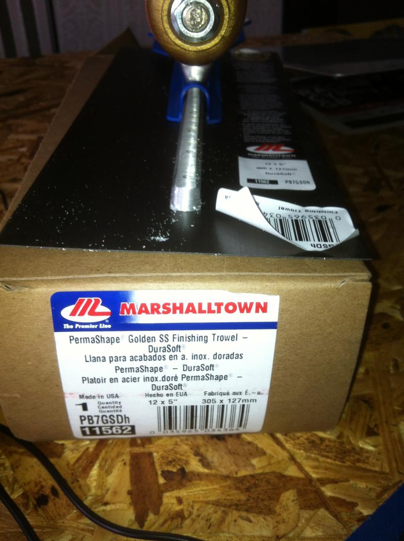

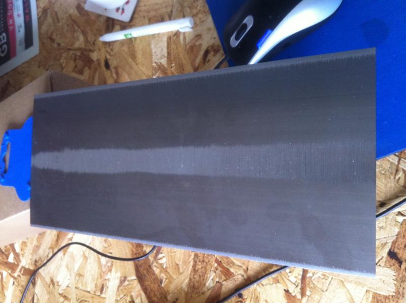

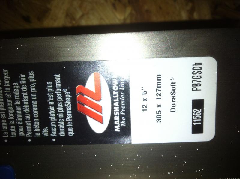

I just bought a new Marshalltown trowel but when it arrived I was suprised that the blade was silver, not gold. It is sold as a 12" x 5" Permashape Golden SS finishing trowel - Durasoft, PB7GSDh, 11562. I rang the dealer who said that is right and they are now this colour but all the pictures I can see on the internet are for a very gold looking trowel. I am wondering if I have been ripped off, been sent a fake or if this is now how they look. Can anybody help? I've put some pictures of mine up :

From the pics yours looks legit. Can see the pre worn grinding, marshaltown engraved on the top face etc. I'm no expert, but it seems to look ok.
when the gold trowel first came out they had the same handle colour as the other trowels but now have the distinct gold handle but unfortunately also the ordinary permashape trowel has the gold on as well I have 4 gold permashape and 1 silver permashape and one stainless steel, if i remember right the gold permashape has supposed to have gone through an extra process so it retains its flexabillity throughout its working life, " just permashape " means that it retains its shape throughout its life "if I remember right". so you have gold permashape and permashape and then you have ordinary ss
the pic of your trowel shows you have a permashape not a gold permashape which is dearer than the ordinary permashape
just a note after a while the gold colour wears off so it looks just like the silver
ok i have looked into this further the number on the sticker on your trowel box says pb7gsdh which is the same number on your trowel now I have gone into my shed to have a look at 2 unused trowels with stickers still on them my gold 12in reads pb7gsdh the same as yours, now on my permashape 13in silver one it reads pb113ssdh now im assuming the gs in the gold number stands for gold stainless and the ss in the permashape stands for stainless steel, the number on your trowel is the same as on your box but its not gold im not sure whats going on here to achieve the gold colour it has an extra treatment so if your trowel is silver this could not have happened here is a pic of the 2 trowels you can see the difference for yourself View media item 69124
Thanks Steve, that is really interesting. I'm beginning to think the ebay seller changed the stickers or something as mine is definitely the silver colour. I sent the pics to Marshalltown in the US to see what they say. I know it seems like a lot of fuss over not a lot but I hate being ripped off.

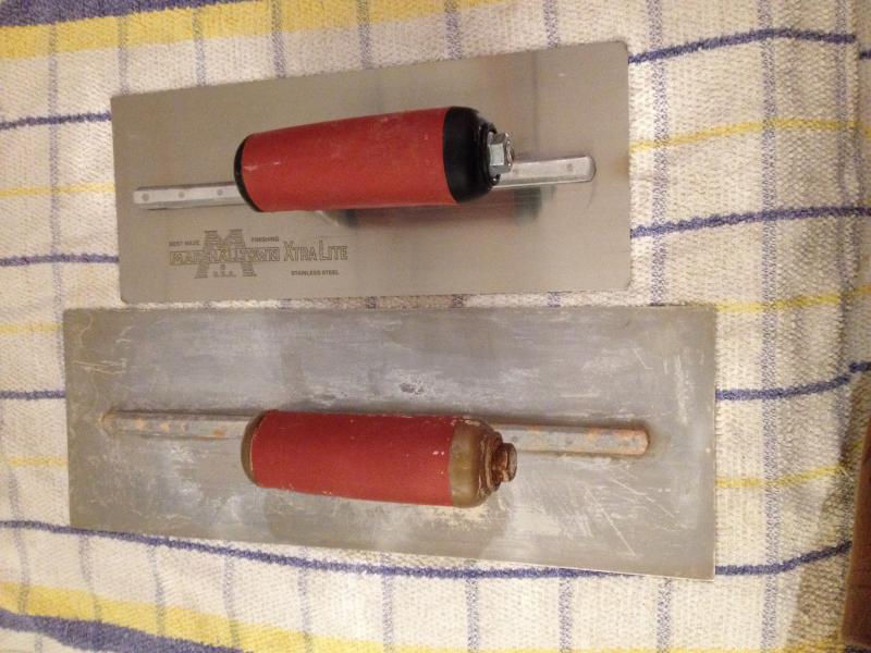

Right I have just been to the van to have a look as I have 2 marshalltown stainless trowels (pics to follow to highlight something)
Both these trowels were bought as ordinary stainless dura soft handled trowels and not gold trowels
My 14" is a permashape and 11" not
Just ignore the phat build up on the 14" it's needs a good scrub
The older 14" trowel has the gold bits (permashape) on and the new 11" trowel just has black bits as Steve says that used to be the difference between permashape and ordinary stainless which I think still stands

This morning I got a response from Marshalltown who looked into in and got their uk importer to ring me up. They said it is the correct trowel and the degree of colour varies depending on the process they use to cool the metal. They said that the colour doesn't affect the quality or performance so all is correct.
