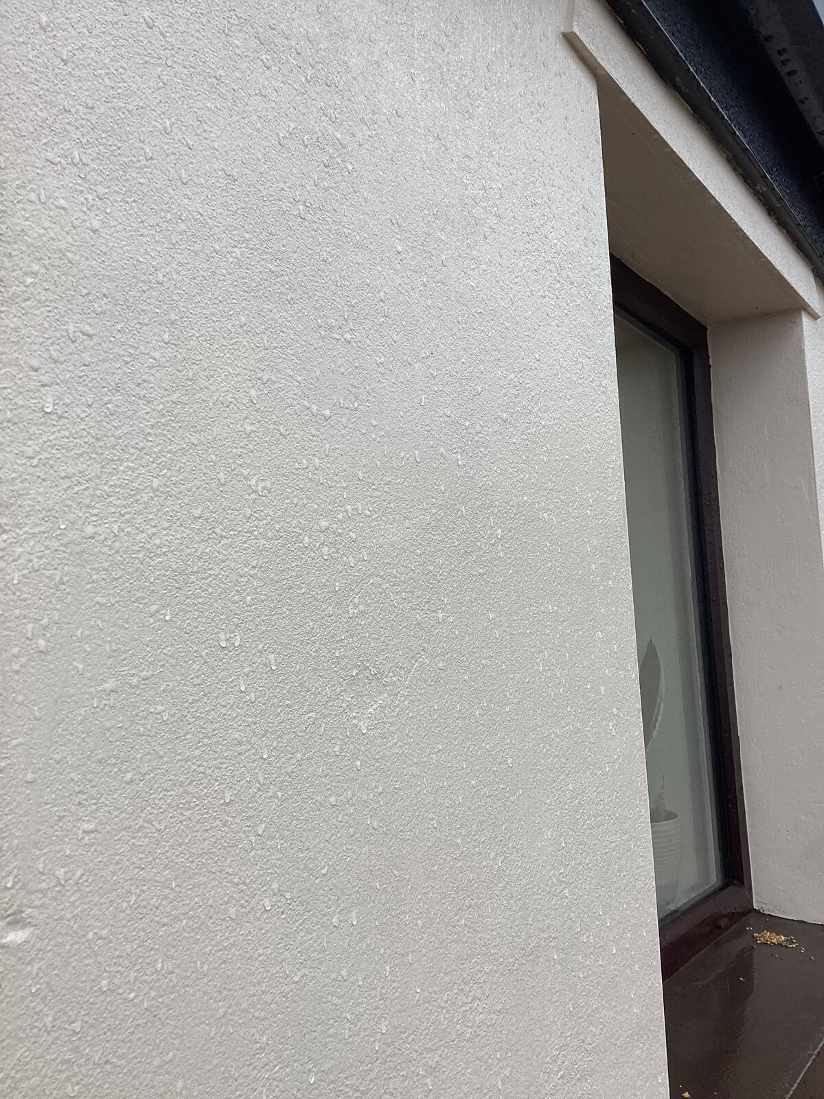

You won’t get much better the Bedec for keeping water out
