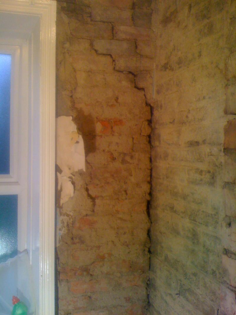

Hi All.
Could do with some advice quick please.
I am re-doing the bathroom removed the tiles to find the plaster was blown so removed that back to brick....then i found this!!

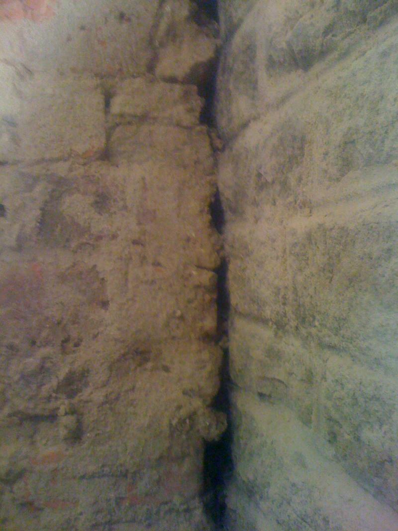

It is a terrace house and this crack is in the back right corner as you look at... there is a slight draft coming through as well.
Any advice would be much appreciated as i am a little worried what it could be.
It's probably old movement. You can either fill the cracks in with mortar or if you are worried fit stitch bars. If the wall was moving your tiles would have cracked.
Cheers Joe-90 much appreciated!!
Your right the tiles hadn't cracked just saw it an i thought oh sh*t!!!
good to get some advice from someone who knows what they are talking about.
Thanks again.
Get the Helifix crack stitching kit, page 104 in Screwfix catalouge, all the stuff you will need is there.
The mortar joints look easy enough to rake out, fit them every 4/5 courses, bend the bars so the go into both walls.

Quite common in old terraced houses when the party walls were not tied in properly to the external walls. The external walls moved out a bit in time, especially if the floor joists were not built into them.
We have used them quite a lot, especially when structural engineers have stated this method, in a couple of barn conversions we have done recently, with far bigger cracks than yours.
You can also get the longer nozzel, so that you can drill through from outside wall into internal dividing wall, you can then insert the twist bar into the the gun via the extended nozzel, push the whole lot into the drilled hole, pump the gun, which is filled with Helibond and slowly withdraw whilst pumping.
Ties outer wall back to innner wall.

You don't seem to have enough wall on the return to enable helical ties to be used to any effect.
It looks like an old crack in any case.
If there are no other signs of distress on the other side of the wall or floor/ceiling below or above, then point it up and board over it
