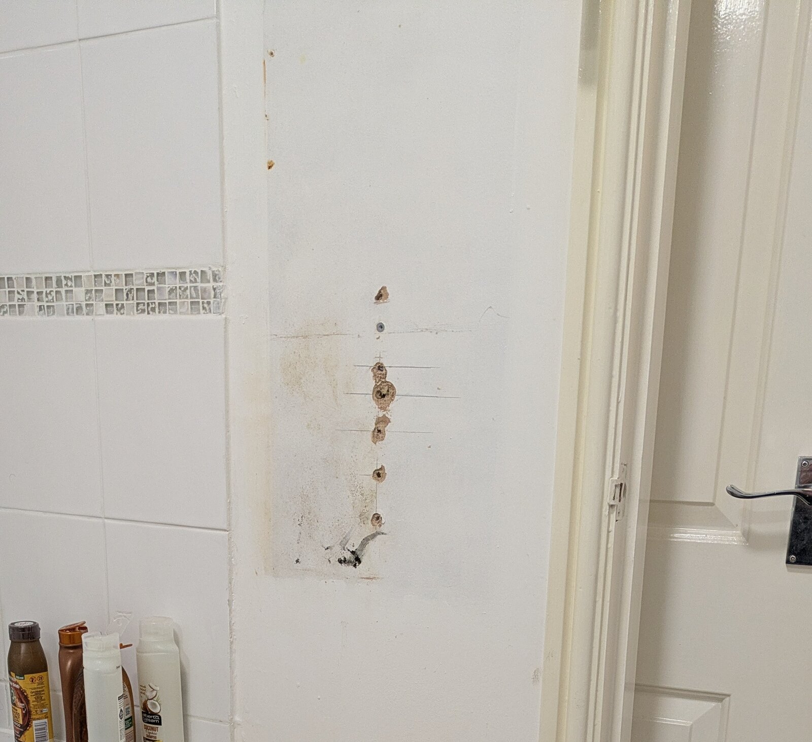

I'll just removed a broken cabinet from my daughter's bathroom wall.
There were no tiles behind it.

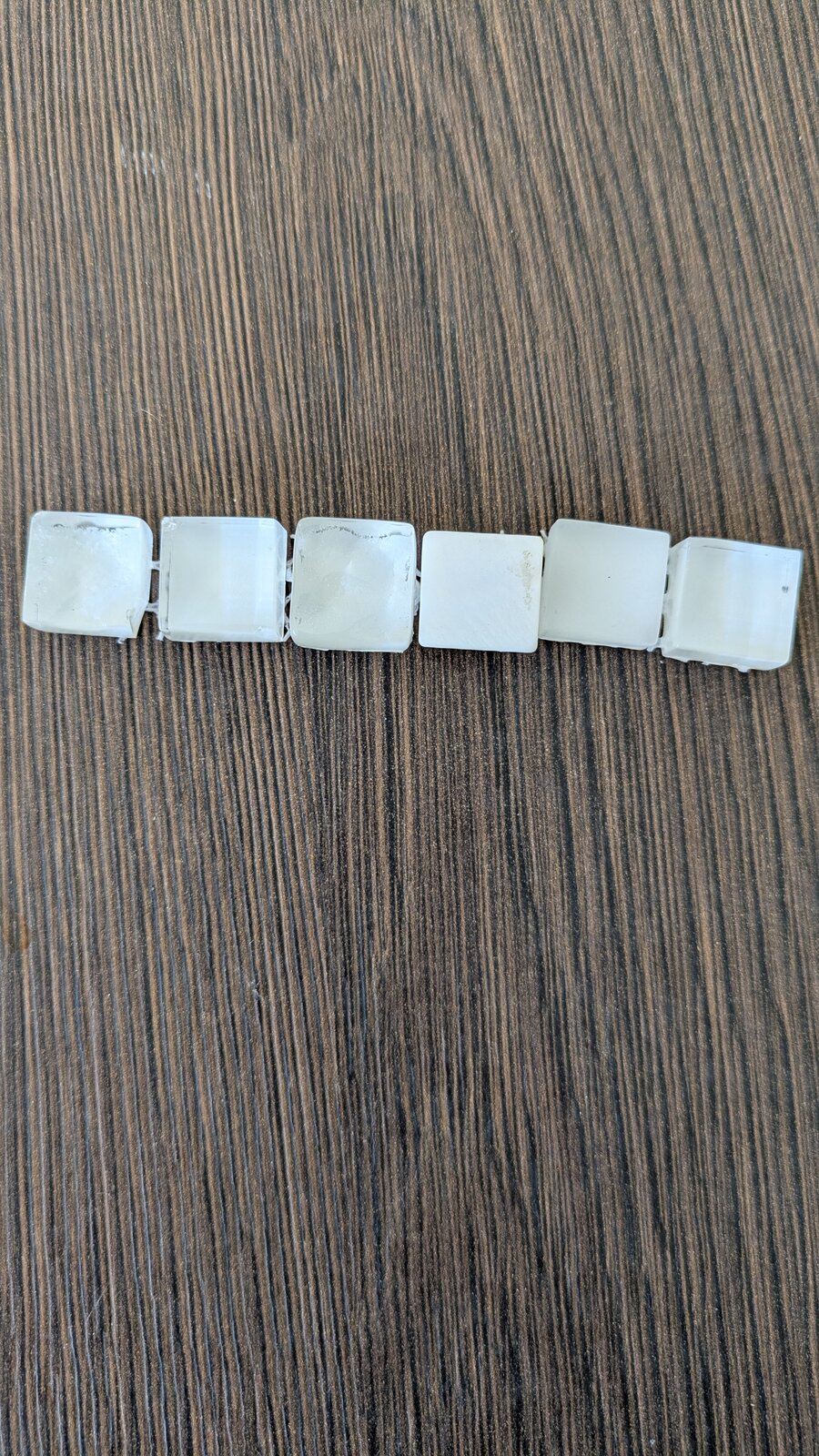

Up in the loft I've found matching normal tiles to finish the gap but only a couple of inches of border tile.
I've tried the couple of tile shops around here but they can't help with matching.

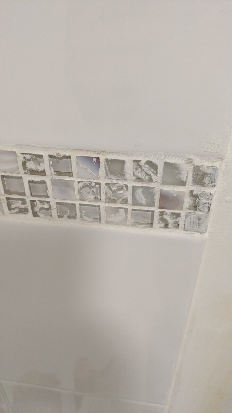

Any ideas how too proceed without replacing the whole bathroom as they aren't really in bad condition on all other walls.
Border tiles are 15mm square, 3 deep, a mix of clear, milky, smooth and rough faces.
I only need about about a metre.

You could search for similar mosaic tiles and cut into strips to form border, might be easier to match .
