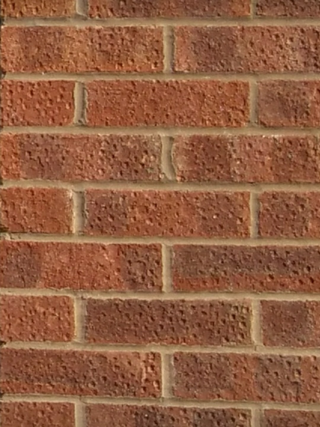

Need to purchase bricks to match existing brickwork, however there are two variants to my knowledge that I've found from looking online
Unsure which ones are on my property
The two I've found are Tradesman Tudor and LBC Tudor.
There is a significant difference in price between the two, why is this?
The house was built in the 70's
Can anyone tell me which are the right bricks I require?

The Tradesman Tudor(Ibstock) are a cheaper copy of LBC tudor (original) they also have perforations rather than frogs,they are still quite a good match and will save you a few quid. Yours will be original LBC.
Bear in mind that for extensions, the planning requirement of bricks "to match" does not mean "the same as". Even if you do get the same type they will tend to look different regardless.

I've been told the tradesman tudor are a better/stronger brick and frost resistant than the lbc tudor originals
Which ones do you think I should go for?
Given that there is no guarantee either will blend in well!
What I've found with a lot of the imitation LBC bricks is that that whilst that have some features of the originals, they are perceptibly different - tend to be darker and the texture is different. Also they tend to stain a lot easier - especially if the bricklayer is not that good with the trowel.
The main advantages tend to be for the bricklayer in that the bricks have holes and not a square frog, and are squarer with more defined edges. The upshot is that they are easier to lay.
I would not worry about frost resistance, that wont be an issue at all so don't use that in any comparision.
I suppose it will be down to price and appearance. If you can't get to see any actual completed walls with the imitation bricks, then if cost is an issue it's whether you want to take a chance and if any difference will be an for you - you may want a closer match on the front of a house say, but on the back you may not really see any difference.

I've placed an order for the LBC Tudors. I would have regretted it if I went for the Tradesman and they didn't look as good as the originals
