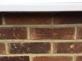

Hi. I want to replace a five or six bricks and match the existing buff coloured mortar. I thought adding mortar dye to a small bag of ready mix might be easier.
Everbuild 208 do a brown and a buff tone - not sure which would be better?
https://www.everbuild.co.uk/product/208-powder-mortar-tone/
Other posts suggest people struggle with a match so should I mix it myself from scratch? Any help with products/ratios would be appreciated. Thanks
i wouldnt use ready mix if trying to match plus no dye just a bag of soft building sand and cement and a not too strong mix
Bobsuerita - thanks. It's easy for me to get to B and Q so would a bag from there be okay (despite mixed reviews)? Alternatively I could get to Selco. They have red sand, yellow sand and kiln dried sand - any thoughts on which one?
Woody - I don't think it is dyed mortar, I was wondering if that was the road to go down but I'll follow bobsuerita's advice. Thanks

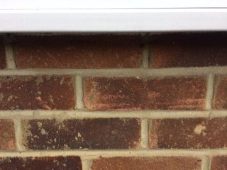

From the picture do you think I should get red or yellow sand?
From the picture I would use yellow with a touch of black dye to tone it down slightly. When replacing a few bricks if mortar is slightly darker than the rest is looks better than if it's much lighter than the existing.
