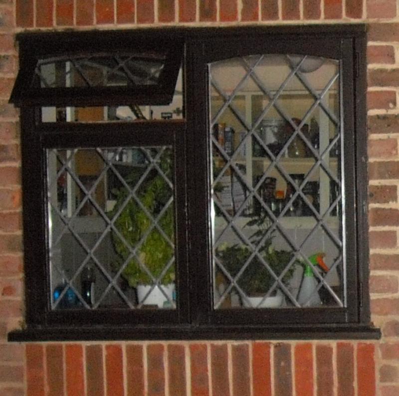

Hi,
I am currently in throw of removing and replacing a window with a larger version and wondered if anyone could identify or possibly know who offers a similar window option... its the top curved bit thats proving illusive......
New size is hopefully 1045 x 1800 - ish......
That's a standard arch-top frame from any good local stockist. Probably supplied by Jeld-Wen (.co.uk)
A 1770 frame will fit - with a packing piece if needed at the door frame
Thanks, I thought it would be a fairly standard jobbie.... BUT any ideas where I can get one? Searched Internet and Jeld Wen site.... nothing!!! Just straight top ones....
