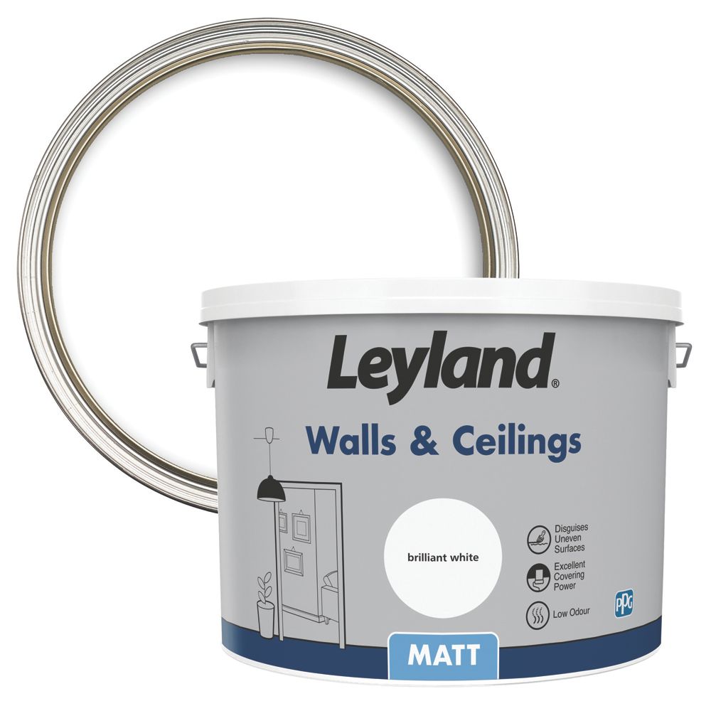

I am looking to do a mist coat on fresh plaster. I purchased the following "Leyland Retail Matt" emulsion:
But then I noticed a lot of people mentioning "Contract Matt", i.e. this one:
So should I swap the retail one for the contract one? Or are they both similar / the same?

The contract one will have more covering power so if you can change it without hassle .....the shop is just round the corner ....but if not a mist coat of the retail will be fine
It's a sacrificial coat to seal to prime the plaster so coverage is not as important as getting a decent , thinned coat on
Coverage can build in second and third coats
