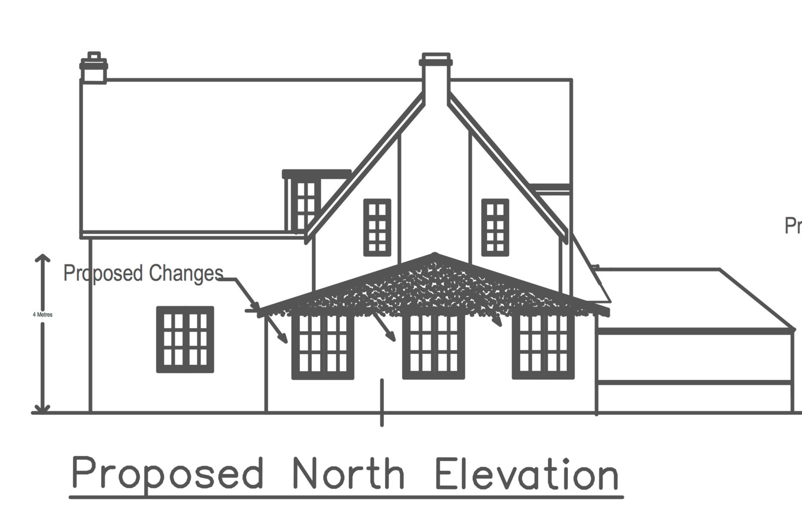

Hello all
We have a single skin 7.8X7.8 mtrs double, attached garage with a flat roof. The walls are single skin brick, with piers at 2.6mtrs centres. Wall plate height is 2.3mtrs. We are converting it to habitable accommodation & are looking for options to change the flat roof to a vaulted roof with scissor trusses. Gable wall will then be nearly 3.8 metres high. Our foundations are good for single storey & soil is good too as seen by building regs.
How high can a single skin brick wall with piers (22X11) go & be stable? Will we have to provide inner clockwork on that wall to support? We are building inner stud walls on the perimeter & have a solid slab of concrete with no cracks.
Or is there something like a lightweight wood-framed gable wall (with hung tiles to match the house)??
Cheers
Fib

You could have a vertical tile hung timber frame gable wall but there other things to consider ,of course ,if you are converting the garage to habitable accommodation.

Google Approved Document A; the suggested dimensions and details for single-skin detached buildings are all in there.

Thanks. I did have a look on that document couple of days ago (and the older version from 2004 as well) but couldn't work out if it applies to my situation. Our garage is attached as well. Guess I will keep looking and reading - I am sure building regs will tell me & the builder when the time comes but wanted to do my due diligence.
As the garage is attached, you need first of all to look at the proportions of the structure on p.14 (2004) edition. There is also table 3 (p 15) giving minimum thicknesses of certain walls relative to their length and height.
There doesn't seem to be mention of half-brick thick walls with piers - they are not normally used for habitable buildings; much is down to common sense and experience. If the wall plate is securely strapped down to the brickwork, the weight of the roof will be a restraining factor helping to stabilize the wall.
Other than that, it's down to calculating the maximum heighth of the wall by treating it as a panel subject to horizontal wind load, and doing the number crunching but that's an SEs job.
But if you have a reasonable inspector, and the wall isn't taken up too high, and well-strapped to the roof, hopefully common sense should prevail.

Thank you so much for the pointers - very helpful & reassuring. Trying to make sense. For some reason 2004 document is so much more detailed in parts. The structural engr. will hopefully soon visit the site & give his input & the Building reg guy seems to be sensible & one who tries to find solutions rather than obstruct. So hopefully......fingers crossed.
The important thing with gables is tying them in to the roof structure, as it's disturbingly common for the gable to be pulled out by strong winds. And this is more of a concern than anything else.
This is difficult to do with single skin brickwork, so anyone designing this garage for you should bear this in mind.
