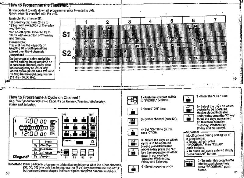

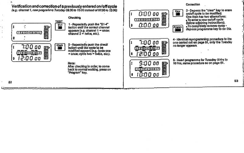

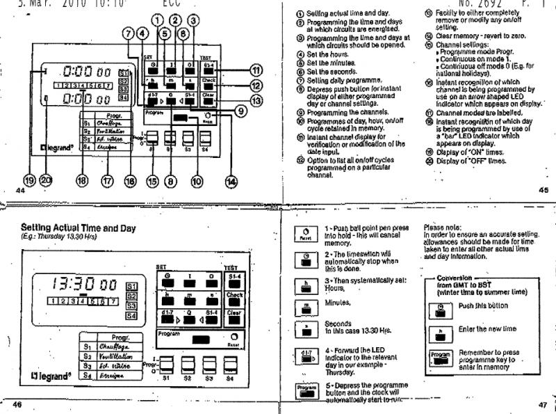

Did you ever find the manual for this? I have the same one and can't get it to remember any times I set. I've looked everywhere in Google and the only thing I can find is that it got a design award in 1983!
Thanks!
