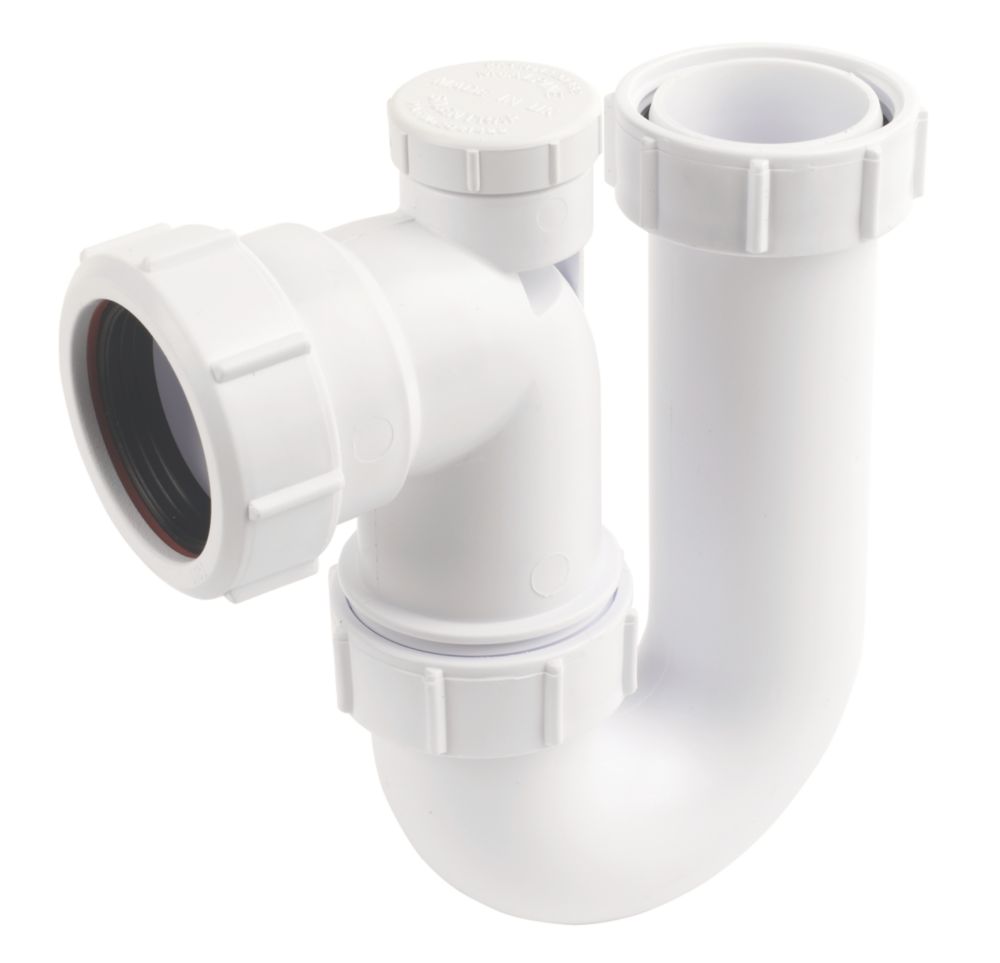

I'm planning to buy this:
If I then want to attach a 40mm section of pipe to the vertical outlet using compression, am I right in thinking I need to buy this to fit into the p trap vertical outlet?:
Vertical outlet ?? Do you mean the top of the trap that would connect to the sink waste?

It's for a washing machine waste. I was going to buy this:
But I'm going to have the top of the vertical pipe completely sealed with this:
So I'm intending to buy the p trap with the anti siphon instead, which doesn't come with the vertical section of pipe included.
Why don't you just buy a p trap with a combined appliance waste spigot ?
If you prefer to use a standpipe and trap ,it doesn't need to be sealed at the top
I'm moving away from the setup with the combined spigot as there are issues with the washing machine draining that I suspect are being caused by this. I need/want the top of the standpipe sealed to ensure no risk of overflow (too long a story) so I'm thinking (hopefully correctly) that it's best to have the p trap with anti-siphon in case air's needed.
Because this trap doesn't come with the standpipe, I suspect I maybe need that straight connector to attach the standpipe?

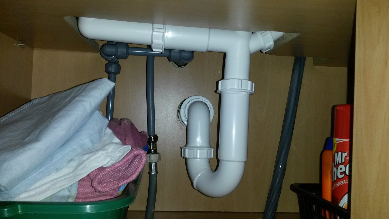

See the following pic. At present there's a 1.5 sink waste kit fitted, you can also see where the washing machine waste is fitted. I want to leave all this in place and blank off the existing spigot where the washing machine currently drains to. Beyond the p trap (pic doesn't show it that well) there's a few inches of horizontal pipework where water then drains behind the back wall of the cabinet. I want to install a swept tee at that section, with a horizontal section of pipe then going off to the right as you look at the pic i.e. running along the back wall of the cabinet. I then want to install the washing machine standpipe and trap to this section of pipe. The rationale is the sinks will essentially drain as they do now, however the washing machine will drain into its own more traditional downpipe.
Unless the pipe that you intend to join into runs horizontally at a lower level than the bottom of the existing trap ,there is no chance of fitting a standpipe and trap.
I know it's not recommended (2 p traps) however the p trap for the washing machine will be located at the same height as the existing p trap. The water from the washing machine will be pumped down the new downpipe, through the new p trap (with anti siphon) and along the new horizontal section of pipe that will run along the back wall and connect into the swept tee that will be located in front of the hole you see at the back wall. In terms of water flow, I don't see why that wouldn't work? The water from the washing machine isn't being routed through the existing p trap, it only routes through the new p trap before exiting. Similarly, the sink water only drains through the existing p trap, it doesn't go anywhere near the washing machine trap.
Go for it ,if it doesn't work you can always put it back the way it was.....what could possibly go wrong ?
Yeah I know ideally rip it all out and run everything through one trap, however I'm hoping this 'extension' approach will work and save the complete overhaul. I'll be sure to update this thread ;)
