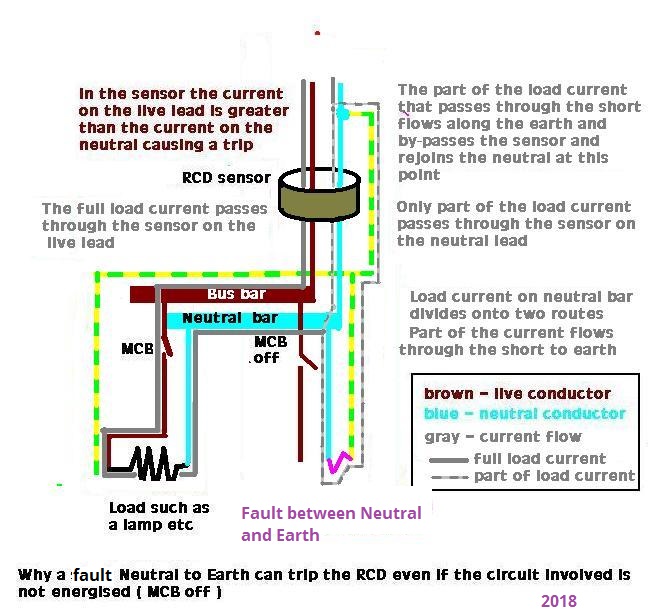

Some electricians cannot understand how a fault on circuit whose MCB is switched off can cause an RCD to trip when a load on a different circuit is switched on. This lack of experience leads them to believe the fault is on the circuit that is supplying the load and not on the circuit whose MCB is switched OFF
Some electricians cannot understand how a fault on circuit whose MCB is switched off can cause an RCD to trip when a load on a different circuit is switched on. This lack of experience leads them to believe the fault is on the circuit that is supplying the load and not on the circuit whose MCB is switched OFF...
I'm sure that, over the years, your oft-posted diagram will have helped a lot of people to understand this issue, but I wonder if you have ever considered re-drawing it so as to make it even clearer?
As I need not tell you, there is nothing wrong with what the diagram shows (in terms of current paths etc.), so I am merely talking about 'aesthetics'/appearance/clarity. Whenever I look at it, it usually takes me two or three 'looks' before I grasp what the diagram is telling me. I think one of the problems is that, at first glance, the solid grey line showing current flow looks like another conductor.
I also wonder if some people might be a little confused by your depiction of 'the point' at which you show the partial neutral current 'rejoining' the neutral conductor - since, other than in TN-C-S installations, that 'point' will be at the DNO's transformer.
Just a few thoughts!
Kind Regards, John
I have often thought that and wondered if DIYers would understand or even distinguish between the parts which apparently touch each other.
Also, I always think it is upside down.
I have often thought that and wondered if DIYers would understand or even distinguish between the parts which apparently touch each other. Also, I always think it is upside down.
Indeed. As I said, although I fully understand what it is intending to show, and despite the fact that I have looked at that diagram countless times, I still usually have to 'take a second look' (if not also a third) before I fully 'understand' the diagram - so, as you say, I think that many DIYers (and maybe others) would probably struggle to fully grasp what was being depicted.
Kind Regards, John
It's the first time I've seen this diagram and I confess my first reaction was to read it upside down, I thought the RCD was individual to the outgoing circuit. Then when I realised my error I didn't find it easy to follow the words and diagram together. Ironically it is completely correct.
Even more ironically this is a situation I have encountered several times and even witnessed 2 CU's being replaced due to exactly this problem, which did not cure the problem of course.
We had this issue at home with a faulty dishwasher but the kitchen ring RCD only tripped when the electric shower was used which was on the other RCD.
