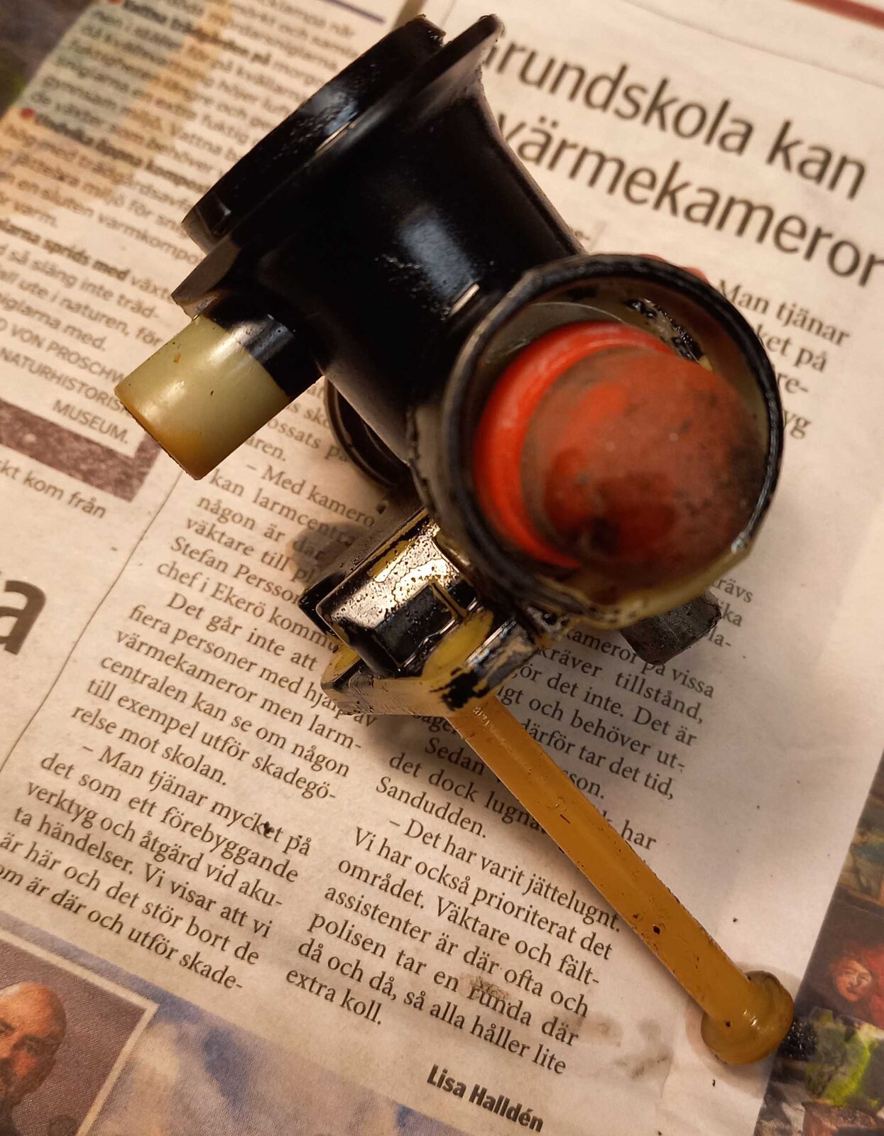

My lawn mower has a plastic carburetor. Where can I get spares for it?
McCulloch 4051CM
Product: 961410044 04
Serial: 050207M 000625
Can I have a picture of the carb please?
Often, McCulloch used Briggs engines and carb, but occasionally Tecumseh got a look in.
John :)

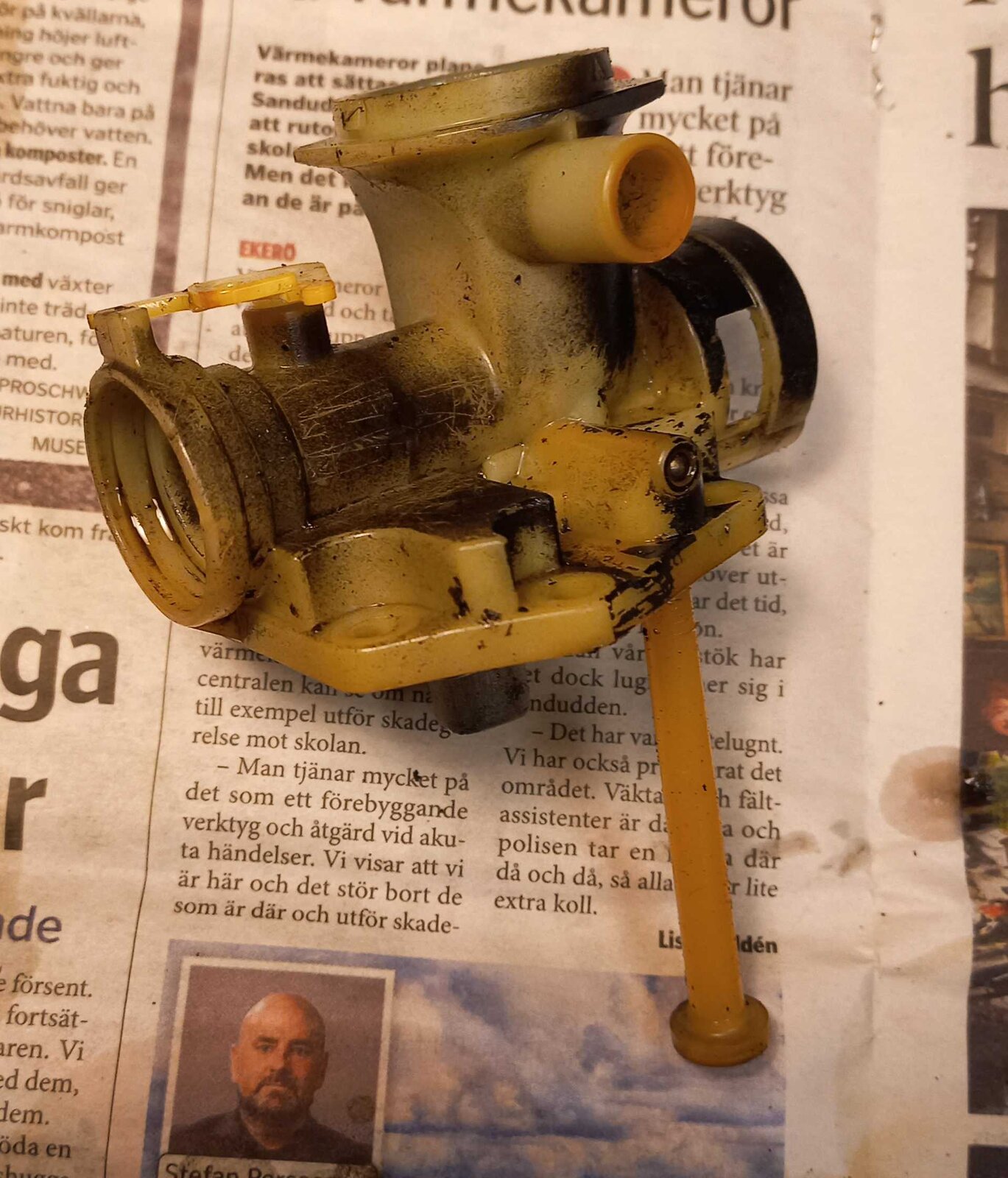

Mercifully, that looks like an old style Briggs Pulsa jet carb.
Does this look familiar to you?
The big problem with these is the filters on the bottom of the dip pipe block up, and the pump diaphragm between the carb and petrol tank fails.
John :)
Yes, this seems to be the one. The rubber bowl is missing from the kit. The mower is from 2007.
What I’ve shown you is the genuine Briggs part, the same form will probably offer a pattern one for less money.
I think the primer bulbs should be available, again from GHS.
Good luck with your project!
John
It was nothing wrong with he carburetor after all. I cleaned it, put it together and the mower runs fine. Thanks.
