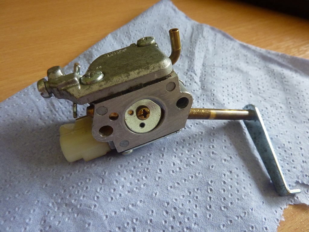

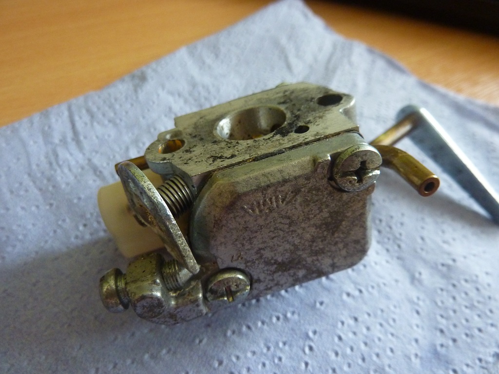

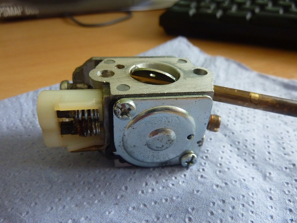

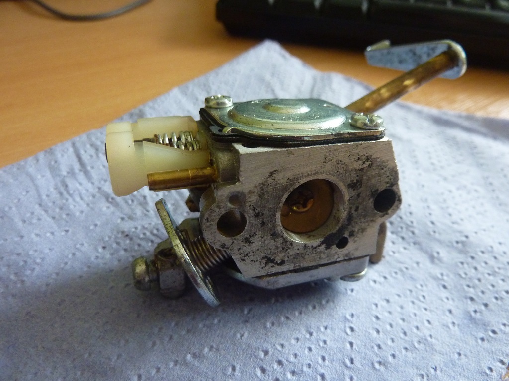

I did get distracted earlier and removed the carb so I could take a better look at it. Photos of the carb below.
We've taken a good look at it for a part number but can only see C1U stamped on it. I've rummaged around the internet and have found the following which appears to be it:
https://agroparts.gr/p/husqvarna-group-467/
This gives some other part numbers so hopefully will help identify the correct carb to buy if I get a new one.
I guess there's no harm in taking this carb apart and checking the diaphragm and float needle. First time taking apart something like this so I'd better have the time to take some pictures as I go.
The C1Q designation shows that it is a Zama carb, actually owned by Stihl now.....somewhere there will be a few numbers written on too.
When you get it apart, you'll find there are two sets of gaskets and diaphragms......often they split on dismantling so new ones are needed.
The diaphragms are next to the carb body - you'll find one has a round metal disc (that's a metering diaphragm) and one has U shaped flaps - that's a pump diaphragm.
Also you'll find a needle valve, spring loaded but no float chamber as such as these engines can run at any angle. Look for a fine gauze filter on the other side of the needle!
The two screws, L for low speed tuning and H for high speed tuning can't be mixed up.
An excellent firm I use all the time is GHS Ltd, plenty of spares, pictures and speedy delivery.
Good luck with your project!
John :)
