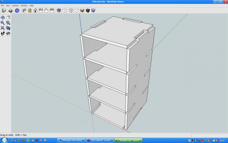

I would suggest 18mm throughout [including shelves] all screwed together to maintain strength, or you risk an empty shell of a carcass collapsing under the weight. Also cheaper , sheets of 18mm are often cheaper than 12/15mm due to quantity sold.

I did a mock up of one design (all in 3/4" including shelves) in Google Sketchup, here is a screen shot of it. The drawing is slightly exploded to emphasize the joints.
What do you think to the way the shelves and sides have been shaped (shelves are identical to the top, the base is the inverse although could also be the same)
I would suggest making a timber table, with timber legs and an 18mm ply top, of a size that the existing drawer units will fit underneath/inside. You can paint or stain the legs to make them blend in.

My plan was to use jigsaw like joints throughout the piece, but this is adding complexity. So I am thinking of going for simple butt joints for the shelves, glued and screwed.
I still want to cut into the top and bottom of the cabinet so that weight is still bearing directly on the side panels (and not just some screws) but so that I can also screw in horizontally as well as vertically - as I believe this adds rigidity to the piece.
If I ended up using butt joins all-round with out any interlocking joints, then I think I would screw through the top into the sides, and through the sides into the base.
