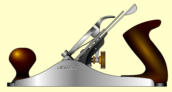

If you sharpen your hand plane you can achieve very, very acceptable results by planning the edge of MDF.
