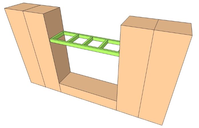

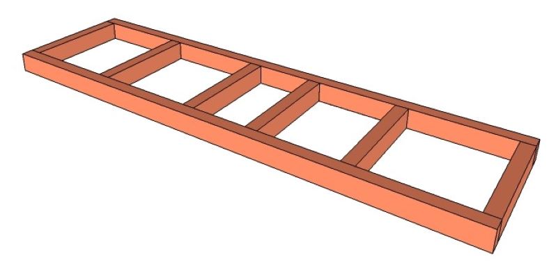

What width, height and depth of unit overall are you looking at? What size of TV are you considering (width x height)? A ladder frame for an 1800mm wide x 500mm deep unit made from 3 x 2in PSE pine would look something like this (assuming 25mm overhangs at either end and the front, you may need to do further work in designing the rear so as to be able to scribe around skirtings, etc):

The bearers are at 400mm centres coming in from each end. They would be better placed beneath the upright end panels of the individual units where they could carry the weight better.

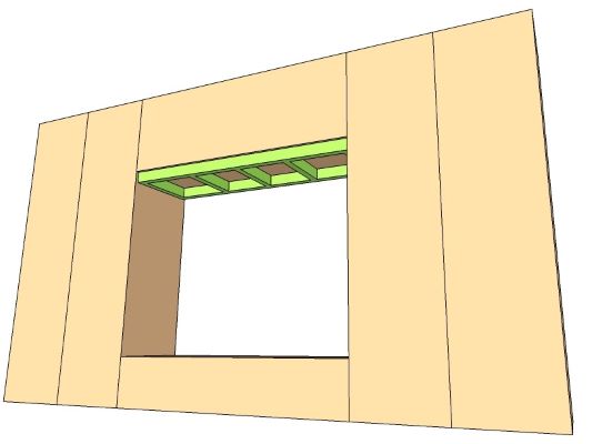

Supporting the flying bridge is another issue. In part it depends on the weight of the bridge and what load it is intended to carry. Personally, I'd consider another 3 x 2in PSE or 2 x 2in PSE ladder frame fixed (bolted, dowelled or at least screwed) to the upright cupboards at either side:

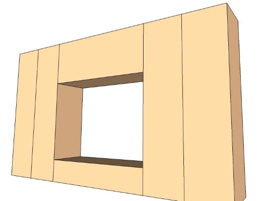

The frame can be boxed in MDF too to hide it:

These are just rough and ready images to illustrate the principles
