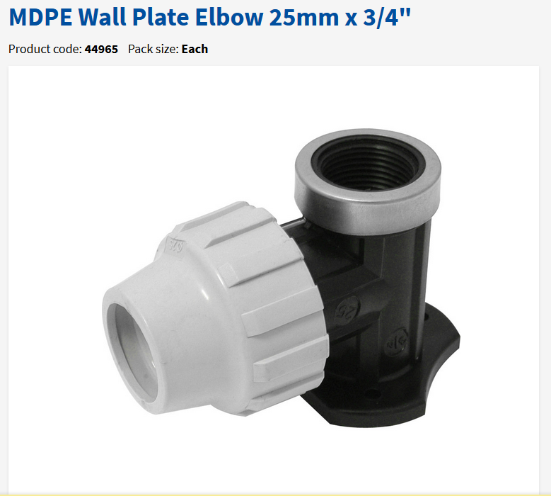

I have one of these, I also have floplast MDPE to 3/4 adapters:
I can't get any 3/4 (22mm) compression fittings to fit the plastic thread, few turns in they all cross thread and strip the plastic thread in the MDPE fitting ...
Am I missing something ??
Ahh, thanks ... been driving me nuts, it appears 22mm compression threads are indeed NOT 3/4" BSP, seems the thread is not to any particular standard, now I think about it - I have a variety of 22mm nuts that have different threads.
