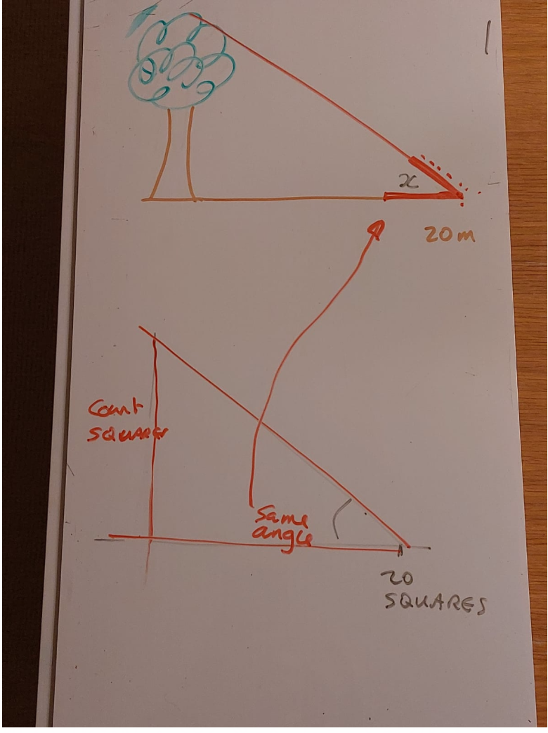

Screenshot 2021-10-28 at 21.05.45.png If the trig is too much (and it's not everybody's cuppa) ...
1. Measure 20m from base of tree
2. Knock up an angle-do da from 2 50cm bits of wood screwed together at one end.
3. Place the doo da level on the floor, and open and sight up the other bit to the treetop.
4. Measure that angle with a protractor.
5. Using graph paper, go along the corridor (L to R) 20 squares.
6. From there, draw the angle back (R to L) till it cuts the vertical axis on the left.
7. count the squares up the side to where the line cuts, that's the height in metres. Approx.

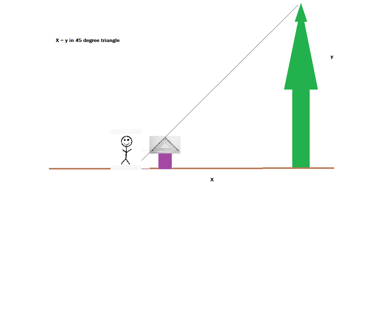

If you have a 45 degree angle, you just need to put it on the floor (or on a level step ladder) at a point where you look along the angle to the top of the tree. Then the distance to the tree is the same as the height of the tree. If putting on level step, add that height to overall height.
A picture:

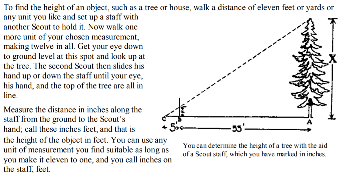

Hold a stick vertical with your outstretched hand in eye sight line with the base of the tree, walk backwards or forwards until the top of the stick is in eye sight line with the top of the tree. Measure the distance from the base of the tree to where you were standing.
It's a typical trick for a wood cutter to estimate where the tree will reach when it falls.

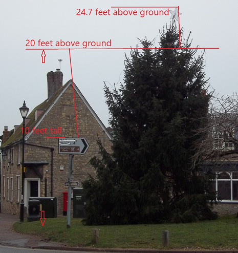

What's 20' ?
The sign isn't.
If the objects are dfferent distances from the observer as above, it's screwed up. You'd have to take that into account which makes it harder than necessary.
Claiming a figurte to a tenth of a foot, isn't valid!
What's 20' ?
The sign isn't.
The sign is ten foot high as notated. Twice 10 is 20.
While I agree the angle of the camera is not perfect for an extremely accurate measurement it was OK for purpose
Of course the star would have been even (slightly) higher if the tree trunk had been more accurately trimmed to set the tree vertical.
( The bottom 3 feet of the truck are trimmed to be a tight fit in the socket in the ground but a curved trunk confused the woodman ).
