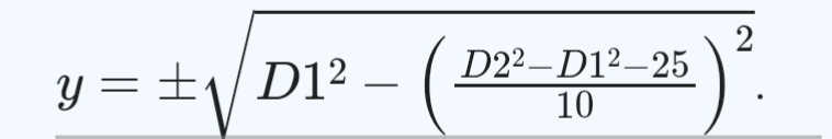

You can use your high school maths! Good old Pythagoras. If you go outside in the evening with a laser measurer, you could measure from where you are to the top of the chimney. You can then measure how far away the chimney is along the floor (might be a little tricky with walls in the way).
Then you can can find the height by doing sqrt(d²-x²)
Where d is the diagonal distance and X is the horizontal distance.
Or, if you can't easily work out the horizontal distance, you can measure the diagonal distance (D1) walk backwards 5m and measure it again (D2) and use this formula to work out the height y. But it's a bit of a complicated formula
Disclaimer - I'm on holiday and have had a few cocktails so my maths on the above formula might need checking.

Check out the edited version of my comment before this one. You can do it with a laser measurerer
I'm sure your maths is good, I wonder if there is a programmable laser measure that could do that calc for me.. like they do the square and cubed metreage...
But if the laser can accurately measure to the top of the chimney then I'm good to go anyway, no need for the actual height. Can it though bounce off an inclined surface and back to me ?
