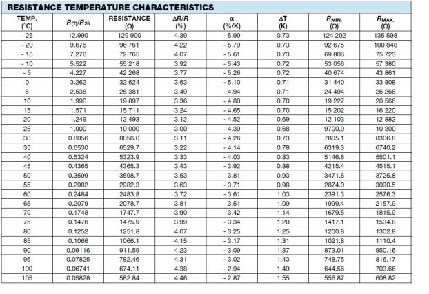

Other than testing whether the NTC is open circuit or not, trying to test its resistance is a mugs game. You need to know it's beta value, and it's current temperature, and then do some maths, to work out if it's reading right or not.
Add to that the fact that these things don't tend to fail other than catastrophically, and that a new part is only a fiver or so, and you see once again why a sensible, professional plumber would just change it and see if the fault goes away, but a google warier would advocate waste far more money in terms of a plumbers time pratting about with a circuit board.
Should be no need to calculate, and besides it isn't always a linear temp / resistance function.
Testing is simple, an ohm meter and a thermometer.
Then use the manufacturers data... This is for the Vishay/BC Components NTCAIMME NTC Miniature Immersion Sensor so do NOT use it for the sensor in your boiler.

As to not verifying the resistance is appropriate for the temperature. If you ( and your customer ) are happy with a boiler whose temperature control is not accurate then so be it.
