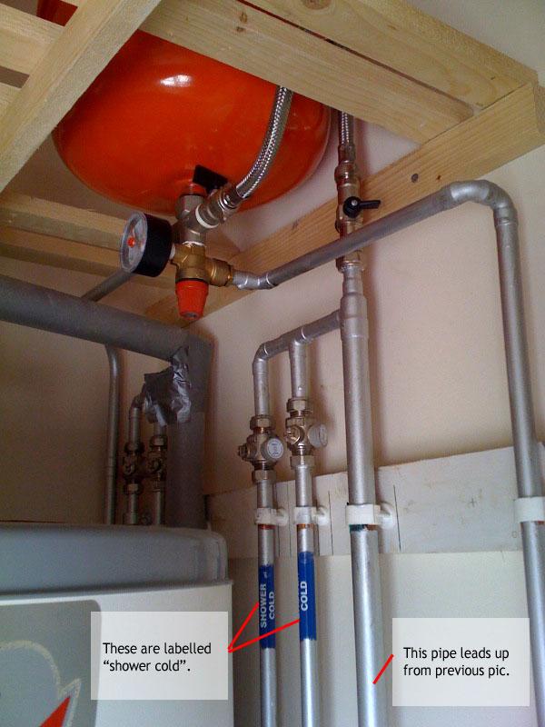

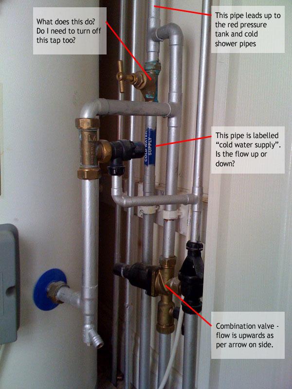

Thanks Joe - that's really helpful! I found the combination valve I think, but I'm a little confused with the pipes I've got so I took some pics:
This is where all the "magic" takes place...
...and this one I've included just for some context as to where all those pipes go!
In the first pic, what is the purpose of the pipe labelled "cold water supply"? Do I need to turn that off also?
If I follow the pipes from the combination valve back to the blue-collared cylinder inlet, there's another black valve that looks similar to the PRV up by the label. Do I just leave that alone?
If I close the combination valve, am I shutting off water to the entire house or just the cylinder?

how many showers do you have? multiple balanced cws taken off, the htg press vessel is confusing too.
isolate incoming below combination valve.
Looking at your pic, and if the direction of the combi valve is correct, it seems that the combi vale does all, if not most of the cold supply. Turning off the black plastic lever will isolate the megaflow, and prob most of the bathroom taps.
Don't need to touch the other black knob further along, thats the expansion valve.
